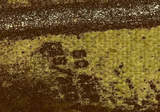

There is an electric stove plugged into this outlet. I can't tell what plug it is to make an adapter for car charging.
photo of outlet
This is in the U.S.

It looks like a NEMA 10-50 all right, but it is labeled 30A.
Electrical Code 110.3 requires you obey labeling and instructions on every device. Therefore, this mismarked device can only be breakered 30A, but anything you'd plug into it will pop a 30A breaker. It is useless and must be taken out of service and tossed. It may not even be a Proper NEMA connector, so a 10-50P may not even fit. Not that you should be using a NEMA 10 to charge an electric car! It invites a shocking situation.

That is clearly a 5, not a 3 before the 0. It’s not mismarked. Use a standard NEMA 10-50R.
I just filtered and brightened and sharpened and zoomed your picture. Even without all that if you look closely you'll see that the dirt and fuzz makes it look like a 3. 5s usually have a flat top and 3s a curved one.

    Hello, and welcome to Home Improvement. Interesting; I wonder why nobody picked up on that (and why the OP didn't take a better picture): thanks. And, you should probably [take our tour](//diy.stackexchange.com/tour) so you'll know how best to contribute here. – Daniel Griscom Aug 19 '20 at 10:44
  • It was definitely a 3. Sorry for not having posted a better picture but it was a cramped space and I didn't have any additional lighting at the time. – Jonathan Aug 19 '20 at 17:42
  • It’s a 5. Use your own filter, then. – Stan Hudson Aug 23 '20 at 06:32

  • It might be a 5 after all, sure as heck looked like a 3 though and still does to me depending on the angle I look at the image. I no longer go there though so I can't go back and check, failed relationship. It would be more like 6 hours for a near full charge even with a dedicated charger for my car which is why 120V was less than ideal. – Jonathan Aug 24 '20 at 20:36
