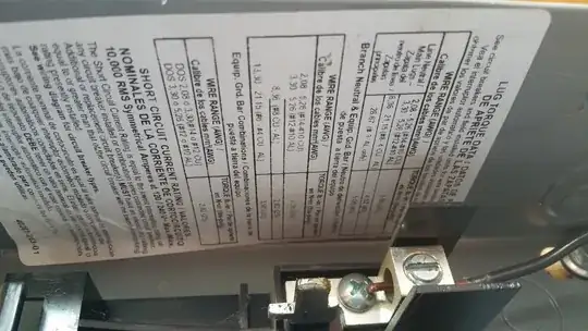

i purchased a tiny house as an abandoned project, and the electricity was already roughed in at purchase. I'm not an electrician, but all the work on the house seems pretty sound from my research. All the wiring is 12/2, with a an RV inlet (30 amp, 125 v). The panel confuses me, as it has both the ground and neutral on a single bus bar. The breaker is a square D 15 amp tandem, with only a single bus bar. Does this look correct? ground and neutral on single bus barenter image description hereenter image description here

    It all depends on what is feeding this panel. Is this the main service drop? If so, the ground and neutral must be bonded. If it is a subpanel, then they must be separated. – statueuphemism Aug 17 '18 at 15:52
  • Where does that cable on the right go? – Jim Stewart Aug 17 '18 at 15:58
  • It appears that there is no bus for the breakers, right? Each breaker slot has its own lug. – Jim Stewart Aug 17 '18 at 16:03
  • Is this tiny home going to have 240 V as well as 120 v? – Jim Stewart Aug 17 '18 at 16:23
  • This is the main service panel for the house with the right cable leading to the RV electrical inlet, meaning it would be connected by extension cord to wherever the hookup would be. Does this automatically make this a subpanel as it would be downstream from any main panel/meter? What happens if the house goes solar with AC/DC inverter/converter? Does that change the required setup in the box as far as ground/neutral goes? – Twill Aug 17 '18 at 16:27
  • Note: the picture has been changed in an edit to the question. The bare ground feed moved since the original question. I state this verbatim because comment and answer text is now out-of-date. – Tyson Aug 17 '18 at 16:45
  • The way it is currently connected both the white insulated neutral and the un-insulated ground would carry current from this panel to the RV plug. I am sure that the connections are supposed to insure that the un-insulated gnd in normal use does not carry current. What this would mean is the un-insulated grounds are not to be connected to the neutrals. Exactly how this would be accomplished depends on how the neutral bar is connected to the large lugs. Test the connections with an ohmmeter. Low or zero ohms means there is a connection, high ohms or "open circuit" means no connection. – Jim Stewart Aug 17 '18 at 17:46
  • @JimStewart what you're looking at there is a 2-space, main-lug service panel. – Harper - Reinstate Monica Aug 17 '18 at 19:06
  • @Harper , so how are the lugs at the bottom connected? – Jim Stewart Aug 17 '18 at 19:09
    The bottom lugs are the neutral bar. Oh God, I just saw the double lugging, *cannot un-see!*. This panel has just enough space on the neutral bar to make it a main panel with 2 fullsize breakers. If you want a sub (as this is) or want to use double-stuffs (as they are), you need a separate ground bar that size. It's not included because they made a beeline for the cheapest thing in the store (literally it's even Homeline, and I doubt it's outdoor rated!) – Harper - Reinstate Monica Aug 17 '18 at 19:13
  • So how would you keep the neutrals and grounds separated? The metal case must surely be grounded. Don't you expect that one lug (say the right one) is connected to the case and the left one is connected to the neutral bar with the 4 screw lugs? Would you twist the branch circuit grounds and the outgoing ground together and out put this set of 3 or 5 wires into the right hand large lug (if you determine that it is connected to the case and not to the neutral bar)? – Jim Stewart Aug 17 '18 at 19:41
  • @JimStewart by not speccing a wildly wrong panel. The case isn't necessarily grounded. I doubt it, I think all are one bus. Heck no, I'm not a hack, one wire per lug unless panel labeling/instructions say otherwise, read NEC 110.3b. Best thing about pushmatics. – Harper - Reinstate Monica Aug 17 '18 at 20:14
  • There are stickers on the inside of this panel. Could the OP post pictures of these? Is this panel currently mounted outside or inside? In a place protected from rain or exposed to rain? – Jim Stewart Aug 17 '18 at 20:47
  • What are the actual *needs* of this tinyhouse? How many square feet is it, and what does it have for kitchen and laundry facilities? What does it have for HVAC for that matter? – ThreePhaseEel Aug 18 '18 at 00:31
This is a total hack job.
It's super cheap, but not even that; there are places money was spent unnecessarily. But the workmanship is a punch-drunk disaster. No one did any research nor asked for any help. The installation is actually dangerous, and could set the tiny-home on fire from an unrelated electrical problem in the facility it's plugged into, even.
Just to breeze you through what's wrong with the panel: #12 on a 30A circuit, no ground bar, lugs double-tapped, missing entry clamp, double-stuff breaker where AFCI may be required, no provision for solar, way too small panel (cannot meet NEC minimums for circuit count). And if it's outdoors: indoor box outdoors, NM cable outdoors, outdoor clamp needed (they don't allow 2 cables), entering a box from the top unnecessarily.

The service panel
That thing actually is a service panel, it's so tiny that it's hard to recognize as one. It won't do. It's a $19.99 Home Depot cheapie, and the worst brand they sell (I think). We're going to spend more like $100 on a proper panel. Panel size is a factor, so we prefer dense panels in smaller sizes. That makes Eaton CH or Square D QO contenders (yes, Square D again, but this time their industrial line) since they pack full breaker functionality in 3/4 the space. (GE Qline goes too far, their 1/2 height breakers can't perform essential functions, other than that it's a fine panel if you use their fullsize breakers.)
As far as spaces, what worries me is that an inspector could come by and require you to have the NEC minimum number of circuits - and also, a few circuits are just a good idea. The former builder used a "double-stuff" breaker to cram 2 circuits into 1 breaker space. Don't count on that, because that inspector may require you use AFCI or GFCI breakers - and those do not exist in double-stuff.

In North America, that would be correct for the main service panel which is directly after the electric company meter, but it is incorrect for a subpanel.
A subpanel should keep separate the grounds from neutrals and connect those separately to the main service panel. This is to prevent ground loops and the serious danger caused by failure of a conductor. See this and especially this.

Presumably one of the large screw lugs on the bottom is connected to the neutral bar with its four smaller screw lugs, and maybe the other one is also, or maybe the other one is connected only to the metal case. You would have to get instructions for this panel an/or use a multi-meter in resistance mode to determine what is connected to what.
Then determine what are the requirements for bonding the neutrals and the grounds for an RV. The question would be should the neutrals be bonded here or should neutral and ground be separate to the RV receptacle?
If another breaker would be added, a jumper would be used to feed it from the lug on the first. If the lugs are not approved for two conductors, then a single one would go through the first lug and on to the second.

    120v 30 amp is a standard for motorhomes travel trailers (smaller ones) but as Jim points out the bare ground should not be on the lug that connects to the breaker. Also there needs to be a grommet or clamp on the wire to the right. I will look up code as this may be considered a main but is normally fed from a breaker panel in a home / RV park so I would treat it like a sub with neutral on an isolated buss and ground bonding to the frame. – Ed Beal Aug 17 '18 at 16:33
