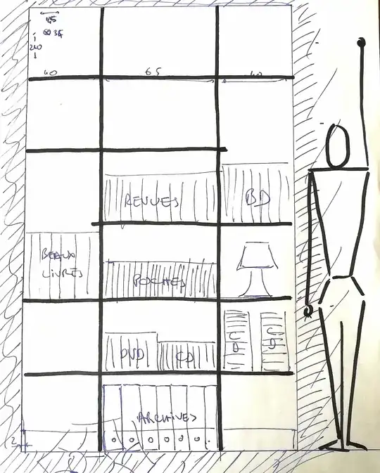

I intend to build a self-standing bookshelf using 18mm-thick, CNC-router-cut plywood. The bookshelf is made of nested planks, and entirely fits a 35cm-deep recess in my wall.
Following pictures display first a sketch of the global design, and second, how I intend to nest planks (click on picture to see them full size):
1/ sketch of the bookshelf 2/enter image description here
Problem:
Although I don't have any children and don't really expect some at my home during the lifespan of the bookshelf, I kind of fear that it could topple frontwards. I am not allowed to secure it using screws in the wall.
Question:
Should I consider tilting either the supports (picture A: α<90°), or the shelves (picture B: β>90°) — or even both — backward by a few degrees to prevent the bookshelf to topple? If yes, which solution is the best, and what angle would be advisable?
A/enter image description here B/enter image description here

It is impossible for the bookshelf to rotate forwards and crush anyone, child or not, the way you have drawn it. For it to fall on someone (who pulled on it, or climbed it) it would have to rotate around point A on this diagram:
Bookshelf leaning forwards
As you can see, before it becomes dangerously tilted the back will hit the enclosure at the top and stop it tilting further. In the event that there is a much larger gap at the top you could push in a block of wood or similar at the back which effectively extends the height so that it can't tilt.
The only way it could become hazardous would be if someone had the strength to pull it directly towards themselves to clear the enclosure, and then tilt it. This is unlikely if it is full of books.

The first drawing is superior with regards to stability. Objects topple when the center of gravity moves beyond the area of the base. In your first drawing the base is enlarged, and the center of gravity must travel further in the horizontal plane to cause a fall. (i.e. You need to pull the bookcase further before it will fall forward.) In the second picture the center of gravity is lowered, which also increases stability. It's not quite as good, however, because odds are good you'll create a situation where the center of gravity must move the same distance but moving it requires more force.
You can, by the way, combine them in other ways to make things stable. Wider shelves on the bottom helps but can be two different sized sections fastened together. (Hutches with large bases, mirrors fastened to dressers, etc.) You can also place heavier objects on the bottom shelves to lower the center of gravity. In your specific case a thick hollow shelf hiding ballast (sandbags or weights) would make it significantly more difficult to tip over.
