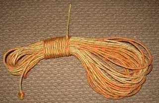

When I get stuff for DIY projects, I regularly use rope to tie it all down to my trailer.
When I coil up a rope for storage I wind it around my palm and elbow (on the same arm) then use the last approx 1 metre to bind it together. However, when I come to use the rope again I often manage to get it tangled up. I think the large loops might get inside each other? I'm not sure, but there must be a better way.
How can I coil up my rope so that it doesn't get tangled?
Here's a photo of how I currently do it:

  • and if you make the loops smaller (or use more rope for the coil) – ratchet freak May 27 '12 at 11:14
    This [YouTube video](http://www.youtube.com/watch?v=8F7eS3TmQiU) shows a good technique. It's a little extra work while wrapping up the rope/cord, but can save time when unwrapping. – Tester101 May 29 '12 at 12:46
  • Thats a tidy looking rope you've got there. – Binary Worrier Jun 02 '12 at 00:38

Around the elbow no good, for ropes they get tangled and for cords they get ruined over time.
See my instructions below, but check out this animation for reference.
Keep in mind, I am right handed and this is how I do it:
Start by placing one end of the rope between your left thumb and forefinger, and grab the rope with your right hand about 2 1/2 - 3 feet away both palms down. While holding the rope in your right hand, grab it between your thumb and forefinger. Now bring your right hand to your left hand so the tips of your thumbs meet (and the newly created loop should form towards your left wrist). At the same time, roll the cord that is between your thumb and forefinger on your right hand away from you. Now grab it with your left hand and slide your right hand down the cord 2 1/2 - 3 feet and repeat till done. The last 2 or 3 feet will be used to wrap the cord/rope.
If done correctly, you'll be able to take the end you wrapped around the cord like in your pic, unwrap it, hold one end and throw the cord/rope to unroll.

Don't twist. When you wrap hand-to-elbow, you're introducing a twist with every loop of the coil. You can make figure-8s (great for small stuff, like this) or you can alternate the twist of each loop (as Gunner directed).

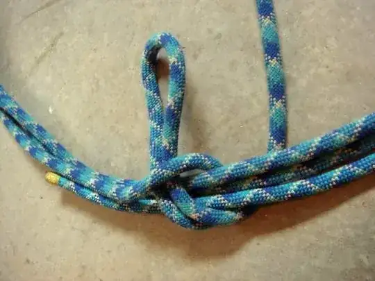

You start with three simple, good sized loops of rope at one end. Then you start by tying a half hitch on a bight around the three loops, loosely binding them together.

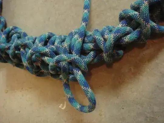

Then in classic daisy chain technique, a bight of rope is passed through the previous loop, except in this case, each bight also wraps around the coil, such that, as the daisy chain progresses, the initial 3 loops will be fully surrounded by interlocking loops.
daisy chain
Once the daisy chain goes all the way around, it continues by wrapping the first layer of loops with another layer of loops.
overlap previous loops

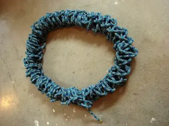

Once the layers of loops get fairly fat, the daisy chain work starts going pretty fast, as each loop requires a decent amount of rope to reach around all the material. When the rope's free end is reached, it's finished by pulling the free end through the final loop.
completed bird's nest
For a little extra security, we cinch the free end around the coil with a simple overhand knot (this last bit is not shown in the above image). It looks like a mess, hence the name "Bird's Nest", but it is actually an ordered series of untwisted loops that are impossible to disrupt into a tangle during handling.
When bringing the rope into service, simply undo the overhand and pull the rope through the first loop and the remaining loops will feed out without kinks or tangles. Once one end is secured, we can reliably drop the nested coil over the edge of a cliff and nearly all of it will feed out cleanly without fail. Any daisy chain remaining at the bottom end is quickly shaken out by a rescuer when he/she approaches the end.
