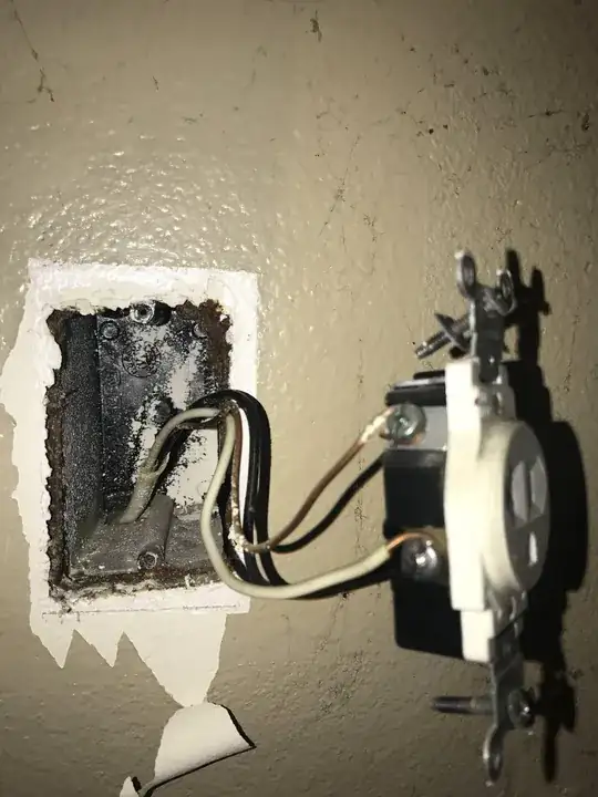

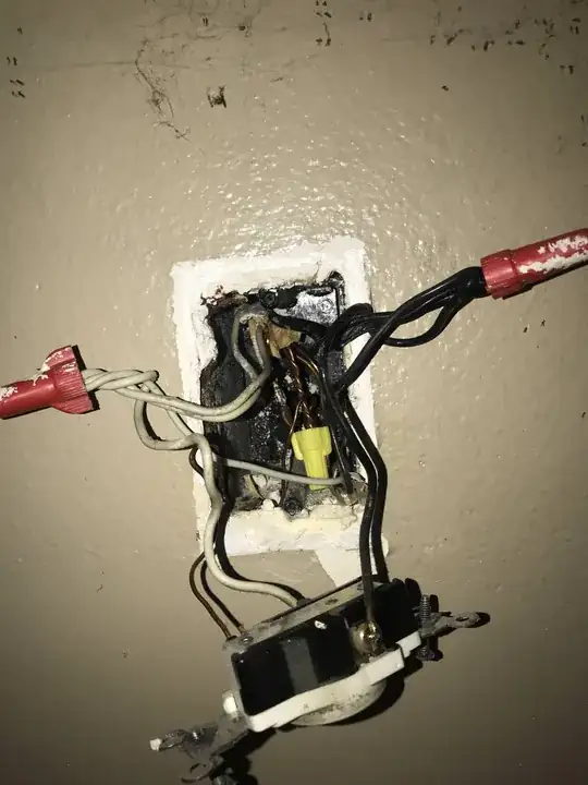

I need two nearby outlets in my house to be on different breakers and different phases of the service. The outlets are currently each on different breakers, but each is on one of the poles of a two pole 20 amp breaker so they are on the same phase. They are #13 and #14 in my panel. If I swap the the red wire(#14) with the red wire from the two pole 20 amp breaker below(#15) as shown in the picture it does the trick. Both breakers are 20 amp so I think this should be ok. I just wanted to see if there is any reason I shouldn't do this? Thanks!
Breakers in question Inside the panel door Inside front door of the panel Full panel Full panel Outlet on breaker #13 Outlet on breaker #13 Outlet #1 on breaker #14 Outlet #1 on #14 Outlet #2 on breaker #14 Outlet #2 on #14

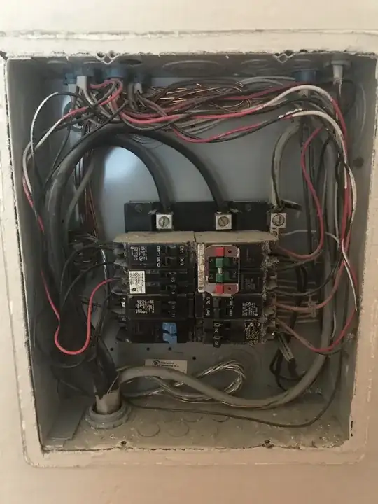

  • Which black wires are in the same cable as the two red wires in question. It seems these are part of Multi-wire branch circuits that share a neutral. The paired red and blacks need to stay on opposite legs because they share a neutral. – Tyson Sep 09 '18 at 18:22
  • The current #13 black and #14 red are in the same cable and on the same phase. The current #15 red and #16 black are in the same cable on the opposite phase. – Phil Sep 09 '18 at 18:32
  • Can you provide a photo of the whole panel interior? I suspect there's something else wrong besides needing to transpose a few wires... – ThreePhaseEel Sep 09 '18 at 19:24
  • Looking a little closer I guess #13 and #14 are a two pole unit. #15 and #16 are two single pole units. In case that changes anything. – Phil Sep 09 '18 at 19:26
  • There is a cable whose red wire lands on breaker #4. Which breaker does that cable's *black* wire land on? – ThreePhaseEel Sep 09 '18 at 22:06
  • Also, @Phil, which black wire pairs with the red wire landing on breaker #9? – ThreePhaseEel Sep 10 '18 at 00:03
  • @ThreePhaseEel #4 red pairs with black on #6. #9 red pairs with #12 black. – Phil Sep 10 '18 at 00:15
    Phil, those are NOT 2-pole units, Those are [double-stuffs](https://diy.stackexchange.com/q/110151/47125). It's very, very important that you know the difference, and if you do not, you should not be in any panel that has any double-stuffs. Unfortunately when super small panels like this are wildly overstuffed , and this one is stuffed absolutely to the max, they present lots of complicated and subtle problems. – Harper - Reinstate Monica Sep 10 '18 at 00:18
    Oh My God. And this panel is full of multi-wire branch circuits MWBCs *also*, and my quick wire-tracing-from-photo confirms that they are doing the **worst possible thing you can do with an MWBC**, typically because of confusing 2-pole breakers with double-stuffs. Seriously. Everything I said last comment, squared. – Harper - Reinstate Monica Sep 10 '18 at 00:22
  • One more thing @Phil -- how is the thing that's wired to #10/#11 wired? (I see what looks to be two black wires that most likely land on #10 and #11, but there seems to be nothing other than NM exiting the panel...something's not right there, either) – ThreePhaseEel Sep 10 '18 at 00:22

This panel has more problems than you can shake a stick at
Not only do you have the mis-wired MWBC pair in #13/#14/#15/#16 trying to slow-cook a couple of neutral wires, you have a bigger (in terms of time and cost to fix) problem with this panel, namely that 75% of your breakers don't belong there as they're the wrong type for the panel you have. Furthermore, it appears that most of your MWBCs do not have a means for a common maintenance shutoff, which also is a Code violation.
As a result, this isn't just a matter of swapping a couple of wires around and washing your hands -- you'll need to replace 75% of the breakers here just to bring it as close to Code as practical for this panel, given that putting a bigger panel in would make this a far larger job.
Problem #1 -- the double-stuffed panel
Whoever put this panel in was penny-wise and utterly pound-foolish, as they put in a panel that was basically half (or less) the size it should have been. This forced them to use double-stuff breakers, which provide two breaker mechanisms and handles in a one-space package, connected to the same leg or phase of the incoming service as they share the same contact clip that attaches them to the busbar.
These double-stuff breakers are different from two pole breakers, which have two contact clips on their back and take up two full width spaces, allowing them to attach to both busbars and provide access to both legs of the feeder, and power things that require 240V as a result. Of course, one can have a breaker that's both a two-pole breaker and a double-stuff breaker. Those are called quadplex breakers, and one can be seen feeding circuits 9-12 in your panel -- each pole-space contains two breaker mechanisms, with the inner pair and outer pair tied together.
Problem #2 -- multi-wire branch circuit mishaps
It seems that whoever wired this condo wanted to save a few pennies on copper, so they made heavy use of multi-wire branch circuits (MWBCs) to wire it. In short, because North American light-duty electrical service is delivered as 240V but with the neutral point set halfway between the 240V legs, if you connect two 120V loads in series and connect the neutral wire to the midpoint of those two loads, the only current that returns down the neutral is current that flowed through one load but not the other load, allowing one neutral to be shared between the two hot wires.
However, this requires the hots to be on different legs, and also requires both hots to be shut off simultaneously when you go to turn things off for maintenance work so that you don't get bit by hot B when you're working on something attached to hot A. Right now, your miswired situation at #13/#14/#15/#16 has neither of those properties, which risks you getting shocked (if you only turned off one of #13 or #14 to work on the garage outlets, for instance), and also is busy trying to light your house on fire, as now you have two hots on the same leg trying to share a single neutral, potentially pumping 40A down a 12AWG wire only rated to handle 20A. (The situation with #4 and #6 only has the former problem, while #9 and #12 are somehow correctly wired to their breaker, but that has other issues which will be detailed below.)
Problem #3 -- the alien invasion
Your panel is a Murray/Siemens loadcenter. This means that UL, as part of the process to get it listed, tested it with Murray breakers in the panel. However, only two of the breakers (#3/#4 and #15/#16) in your panel were made by Murray/Siemens to begin with. The remaining breakers are of the wrong type to be used in a Murray panel (there's a Square D HOMT at #5/#6, and the rest are Eaton/C-H/Westinghouse/Bryant BR breakers) and thus have not been tested for proper compatibility with a Murray panel.
This is what drives the need for breaker replacements here -- the last installer (or installers, even) whacked in whatever they had on the back of their truck instead of getting the correct breaker for your panel. Note that you are best off shopping at an electrical supply house that stocks Murray/Siemens, or ordering the exact part numbers you need online from a reputable distributor -- the big box stores generally don't have a great selection on these things, which may be part of the reason your panel was invaded by aliens.
Eating this elephant, one bite at a time
Fixing this panel will be a multi-step process, requiring:
  • Temporary number tags (1-16) to put on the existing wires so that you can tell which wire goes where when rewiring this thing -- if worse comes to worse, you can use flags of masking tape for this and scribble the numbers on with Sharpie
  • And replacement breakers, namely (these are exact Murray/Siemens part numbers, and are the only parts acceptable here):
    • a MP21515 (Q21515CT) for #3/#4/#5/#6
    • a MP220230CT2 (Q220230CT2) for #9/#10/#11/#12
    • and a MP220220CT2 (Q220220CT2) for #13/#14/#15/#16
The first step, of course, is to turn the main breaker for your condo off. Once you've verified that nothing's live in your panel, then you can tag the hot wires #1 through #16 based on which circuit in the panel they are hooked up to at this point in time -- we'll be using these numbers later when we hook stuff up to the new breakers. Once everything's tagged, you can then unhook all the wires from the old breakers, and pull out all the old breakers -- put the ones for circuits #3/#4 and #15/#16 with the new breakers as we'll be transferring those to different circuits as part of this, and dispose of the rest appropriately.
Now that you have all the needed breakers at hand, you can install them into the panel. The MP2020 goes in the space for circuits #1 & #2, the MP21515 goes into the spaces for circuits #3, #4, #5, & #6, the MP1515 goes in the space for circuits #7 & #8, the MP220230CT2 goes in the spaces for circuits #9, #10, #11, & #12, and the MP220220CT2 goes in the spaces for circuits #13, #14, #15, and #16.
Once that's done, then it's a matter of wiring the new breakers up. The wires labeled #1, #2, #3, #4, #7, and #8 go back to the same circuits they were always on, while #5 and #6 are swapped to provide a common maintenance shutoff for the #4/#5 MWBC -- this puts the wires labeled #4 and #6 on the inner two poles, while the outer poles get the wires labeled #3 and #5.
Moving on to the right side of the panel, the wires labeled #9 and #12 connect to the two 20A poles of the breaker that services #9/#10/#11/#12, while the wires labeled #10 and #11 connect to the two 30A poles of that same breaker. Finally, we get to the situation you originally asked about; for this breaker, the wires labeled #13 and #14 connect to circuits #13 and #16 (aka the two outer poles), while the wires labeled #15 and #16 go to circuits #14 and #15 (aka the two inner poles).
Once everything is wired up and tightened down, and the temporary number tags removed to avoid later confusion, then we can button the panel up and turn everything on save for the #13/#16 handle (which will be ganged together), as we'll be moving onto that next -- note that the breakers I got for the MWBCs not only have common maintenance shutoffs, but common trip functionality as well, which will be important when we move onto the garage circuit.
Now that the panel's corrected, there's a much less hinky way to get 240V at the garage
Now that we have the breaker panel straightened out as best as possible (ideally, we'd get GFCI and AFCI protection installed, but that requires wholesale replacement of the panel with a much larger one, something beyond the scope of this project), thanks to the MWBC wiring that's already there, we can make it so you have 240V in the garage without the need to screw around with dodgy adapters. You'll need three things besides the breakers for this, and those are a Leviton 5844-I combination 5-20T/6-20T receptacle, a wirenut accepting 3 #12 wires, and a piece of red 12AWG wire to add to the existing pigtails.
At the box that you labeled "Outlet on breaker 13", you'll want to unhook the receptacle from the existing pigtails, and also undo the wirenut that joins the black and red wires together. Use your new wirenut to add one end of the 12AWG red pigtail to the junction of the black and red wires, and then wire the receptacle as follows (feel free to use the screw-and-clamp backwire system on this receptacle, or the side screws instead if you're more comfortable with those):
  • Black pigtail to one of the brass screws on the opposite side of the receptacle from the silver screw
  • Red pigtail to the brass screw on the same side of the receptacle as the silver screw
  • White pigtail to the silver screw
  • And bare pigtail to the green ground screw
Last but not least, button up all the receptacles on the garage circuit, and turn the #13/#16 breaker back on.
