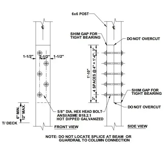

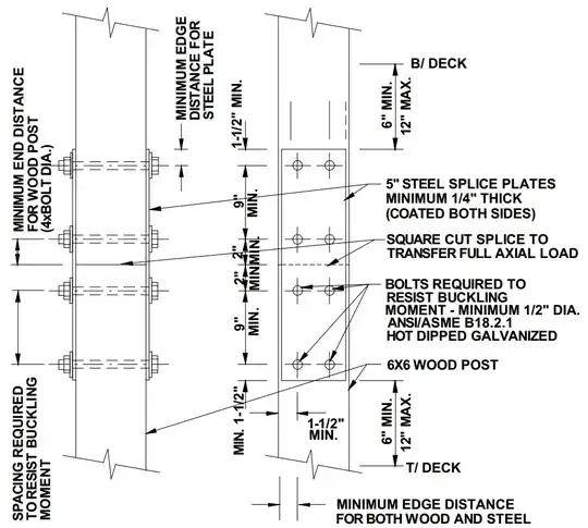

Here's an excellent pictorial breakdown and quite detailed explanations of most types of joinery: US DOT
According to Chicago's exceedingly stringent Deck Code (pages shown are labeled 34 and 35) you can do either a half lap or a butt joint. Both require hot dipped galvanized (min. 1/2" or 5/8", depending on splice type) through bolts, washers and that they be 6x6's in the first place.
Having to transfer this to a 4x4, I'd pay special attention to the minimum edge distance of 1.5" and probably do a lap splice for its staggered pattern, cheating the distance of 2.5" between the fasteners and maybe a 1/4" off the MED.
  • This code probably ignores hurricanes and earthquakes.
  • DO NOT OVERCUT. This would provide a shear plane much like a glass cutter does.
  • The splice should avoid the location of the hand rail and begin a minimum of 6" off the deck.
Half Lap Post Splice:
Post Splice Using Plates:
