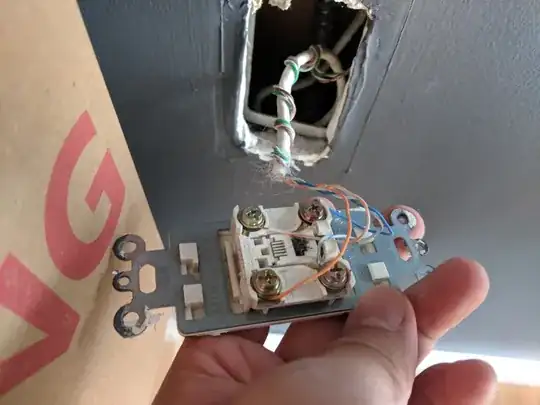

Around the unit there appears to be an RJ11 that terminates the other end of the white cable with four wires:

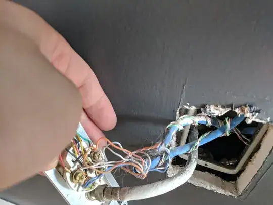

Plus two RJ11 jacks that seem to have some sort of daisy chain situation going on with the blue cables:

  2. Why are some of the RJ11 jacks terminated with a single cable and others daisy-chained?
  3. There are 3 blue wires coming out of the telco closet and 6 blue wires emerging elsewhere in the house (2x single and 2x double). This seems to imply a logically impossible daisy-chaining situation to me, and I've looked very hard and not found any other RJ11 jacks. How could it be wired this way?

  2. I'd guess the daisy chaining was a poor mans way of propagating the phone cable without running it back to the closet.
  3. Yeah, see the last answer

I'd say you can terminate the cables you need with wall plates in the rooms, RJ45 jacks in the closet and if you need additional service to one of the daisy chained rooms, you can add a switch where needed to continue the chain. Mount the switch to the wall close to the wall jacks to get it out of the way.

  • Yes, daisy chaining is not unusual for phone wiring. But it won't work for Ethernet. – AndyB Aug 28 '21 at 19:23
  • @AndyB Okay, so I have the same thing - 3 sets coming to one port (the type with the screws on the back as shown in OPs last photo like you were talking about not being unusual. I just added an RJ45 port and am trying to leave the RJ11 (so I am installing an additional run without disturbing the existing daisy-chained RJ11 via a 2 keystone wall plate) but am very confused how I am supposed to terminate (specifically punch down) 3 cables. I didn't even know that was possible, but it was done easily with the screws and I can't seem to "upgrade" or at least update that port. – Cfomodz Sep 10 '21 at 06:43
  • @Cfomodz It looks like you got good answers when you asked it as a [separate question](https://diy.stackexchange.com/questions/234541/how-do-i-update-daisy-chained-rj11-to-standard-punch-down-style-keystone-jack). – AndyB Sep 11 '21 at 19:40
