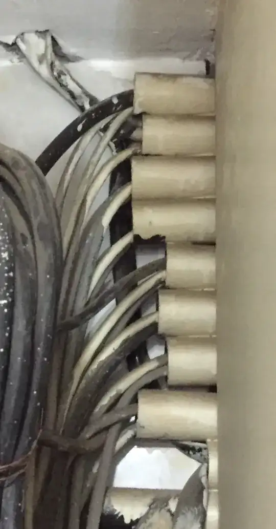

Here's some old wiring done in my absence as my parents could only monitor so much.

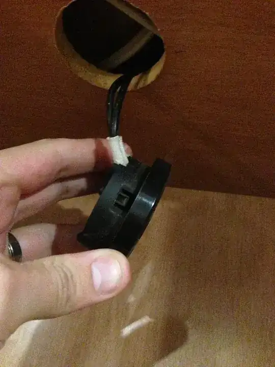

Hate the use of Skinnier version on Flexi Pipe that won't allow any movement or pull once initial install is done. Crappy. (Hidden behind the black pipe)
flexi pipe 2 cat 6 + c1 coax
2 Cat 6 + 1 Coax
It comes out over here at one of these pipes. I forget which one (we traced it w physical push pull)
conduit pipe 3/4 or 1 inch
Conduit Pipe is 3/4 or 1 inch. Need to check in morning.

This old school electrician guy is helping me out so we trying to figure out & have some debates.
  • He is saying there's no way we can add a 3rd Cat 6 given the thick Coax we have.
  • Now I'm wondering if this was due to the flexible piping being the cause of his thought.
If we were to avoid flexible Pipe and do the following;
  • Only straight Runs
  • only use pull/ junction boxes or none at hidden turn locations (concealed above ceiling)
  • Use straight or 135 degree angle at 1-2 places through a wall (if at all we have to do that) will try to avoid.
What kind of Cat 6 + Coax additions/ increases could we do to the existing bunch?
Or do we for for 1" or a Second Conduit to add more. Thoughts?
Assume new conduit and flexible piping drama / flaws be eliminated.
