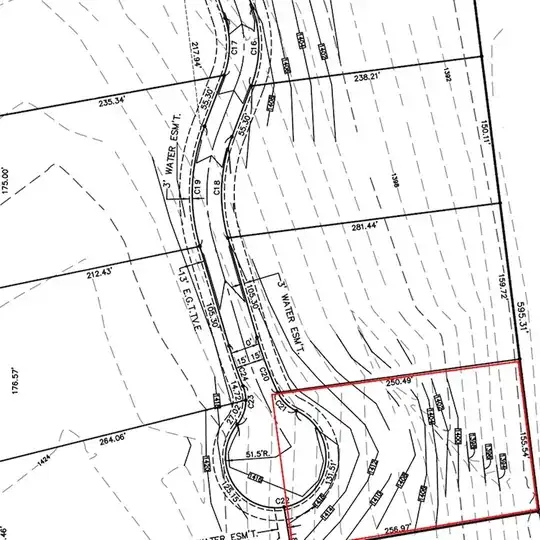

Site plan
This is the site plan with the building in red.
site plan

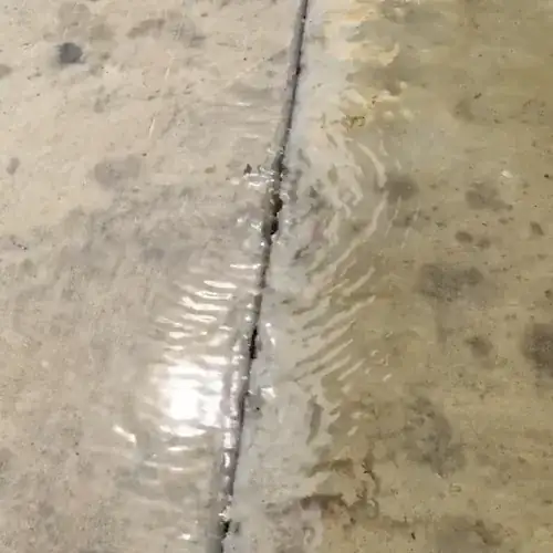

Saw cut: Flowing from saw cut; seems to be high flow with visible water movement and pooling ~2 inches deep.
water from saw cut

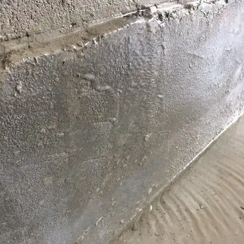

Wall/Floor Joint: Flowing from wall/floor joint; seems to be high flow (but less then the saw cut) with visible water movement and pooling ~1 inch deep.
water from wall/floor joint
