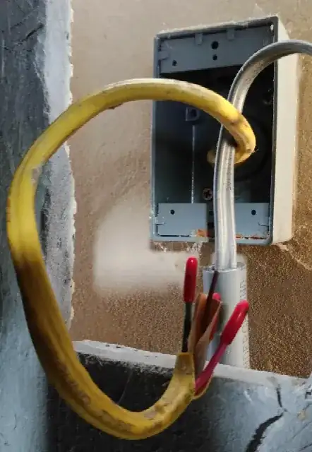

I did quite a bit of research including on this forum but wanted to double check if I got things right. On the outside of our home there is a standard electrical box (guessing about 3"x5") to install an outlet. There is no outlet yet but just a cover and inside the box is a 4-wire (3 conductor + ground) 12AWG cable with red, black, white and bare conductors. It was meant to be used for an outside kitchen appliance but then stayed unused. However, I have a need for a 120V (GFCI?) outlet at that position and need to pull 120V to an outside counter top. The pipe from that outlet to the counter top is already in place. All of this is shown in the image below. The electrical box with the yellow wire (3 conductors + ground) and then the pipe with the gray wire that will go into the box.

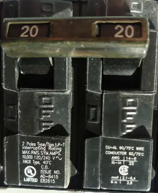

On the breaker box there is a double 20A breaker. See the second image below.
So the idea is to do a MWBC. I would connect:
  • White conductor from yellow cable to white on gray cable + neutral on standard 120V receptacle.
  • Bare conductor from yellow cable to bare on gray cable + ground on standard 120V receptacle.
  • Red conductor from yellow cable to black on gray cable.
  • Black conductor from yellow cable to hot on standard 120V receptacle.
Since the black and red are on different phases I should be able to pull 20V from each without burning up my neutral. Does that plan sound correct and is that up to code?

  • The only thing I see that looks wrong is the neutral needs to be pigtailed, not using the outlet as the connection. – Ed Beal Sep 24 '18 at 13:30
  • ThreePhaseEel, one will terminate at the box and one at the countertop some 15' away. Jim, I was planning to install GFCI outlets but Harper mentioned GFCI breakers. I like that idea and might take that route. Ed, I will definitely use pigtail. I guess my drawing wasn't clear. Thanks for all the input. – Hu F. Sep 25 '18 at 02:33

First, congratulations. This is the most well-thought-through presentation of a plan that ai have ever seen on this forum, and your thoroughness has paid off - you got everything right, including an ambitious use of a MWBC, with all its details right.
By your first paragraph I was thinking "MWBC" and voilà you're already there. Well done.
The breaker
Is absolutely fine and I would not mess with it. Even if you were to downgrade to a simple 120V circuit, it is fine to just use half of the 2-pole breaker and disconnect the other wire from the breaker and cap it in the panel.
Your idea to go with a single breaker isn't wrong but it will leave a gaping hole in your panel. They make blanking covers but they're hard to find, expensive, and flimsy -- so I prefer to fill empty holes with actual breakers and just mark them n/c. So then you'd be right back where you started, but $10 poorer and with a nice 2-pole breaker to mislay.
The only breaker swap I would consider is swapping to a 2-pole GFCI breaker. That lets you provide the GFCI protection for both half-circuits in a dry location, so you aren't paying extra for outdoor GFCIs or enduring their horrible failure rates. The 2-pole GFCI breaker would also allow you to use every MWBC trick in the book without having to worry about how GFCIs interact with MWBCs - from hot-skipping on a long line of receptacles, to provisioning a 240V receptacle also.
