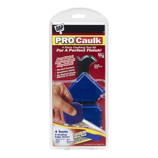

Do not use tape, cut the tube of silicone at a 45 degree angle and apply it as if that is the final application. Now use a ~$5 tool like this*:
Caulk tool
to spread the silicone. Its triangle has three different radii from eighth to quarter inch. It is made of silicone so it works better than any of the above suggestions. I do this for a living in all the bathrooms in a 400-room 4-star hotel. Use isopropyl alcohol to wipe any super thin layer left behind beside the caulked seam itself. Use neoprene or latex gloves and a rag to wipe off excess caulk that collects on the tool.
*Example only, not a recommendation

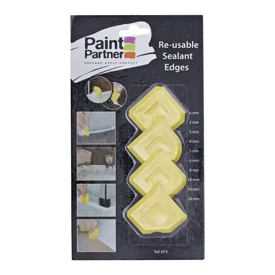

  5. Use these amazing "Sealant edges" for a perfect finish. Reusable sealant edges
  6. There's different corner sizes from 0mm, 2mm, 3mm, 4mm, 5mm, 6mm, 8mm, 10mm, 14mm to 20mm to match the job. Scrape off the excess sealant, discard with tissues or disposable cloth.
  7. Leave to cure 24 hours minimum for a perfect finish!
