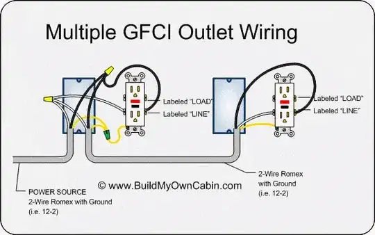

Let's see if we can answer this in pictures. For one feed from the breaker panel, to have each of the outlets on their own GFCI, you want this: enter image description here

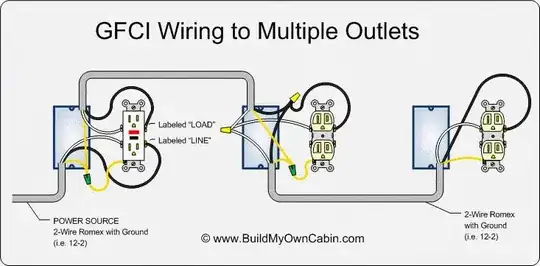

For one feed from the breaker panel to have one GFCI protecting downstream outlets, you want this: enter image description here
