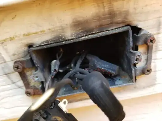

I noticed my tooth brush wasn't charging one morning and none of the plugs in my bathroom were getting power, I went down to the circuit box and saw a flipped breaker so I flipped it back and it immediately tripped again. I tried it once more with the same result so I started to investigate the plugs in my house to see if anything was obviously wrong.
The external GFI on my deck had obvious signs of smoke on the siding so I disassembled the outlet and the entire back of the GFI blew out.
Is that a normal failure mode? Could it be a manufacture defect / installation issue?
There was obviously a lot of heat as the wire connectors appear scorched and the box is filled with a thick black soot.
Do I need to worry about additional damage to the wires beyond what is visible in the box or can I just remove the damaged wires and install a new GFI? Time to call an electrician?
Additional GFI Outlet Images

    What type of cover did it have? My guess is water went in thru the face and saturated the circuit board inside. The wire insulation (except the crispy ends) remains intact, suggesting the fire came from within the GFCI, not the area beside or behind it. – Tyson Nov 12 '18 at 14:19

This happens all the time if an exterior GFCI is not weather-resistant. I've never had a weather resistant GFCI go up in smoke.
Yes, they can be in a metal box, but they still should be marked WR (weather resistant) - this means the electronics inside are coated to reduce the chances of moisture causing exactly what happened with your GFCI.
If it had shorted to the box, the metal screw would have arced and tripped the breaker. If it had shorted on the load side, it would have tripped the GFCI. But, in this case, enough moisture got in and the electronics shorted and let the magic smoke out.
Last item on the list is that it should have an in-use cover or an extra duty cover, that allows a cord to be plugged in with the cover protecting from rain.
In this case, replace your GFCI with a WR rated GFCI and add an in-use cover to greatly reduce the chance of this happening again. In some jurisdictions the local ordinances require the outlet itself to be GFCI so it can be reset (not running cords inside because of tripping the GFCI in wet grass with an electric mower is the "why" the inspector told me).

    This exact same situation happened to me with a weather-rated box. As is often the case with catastrophic failures of safety systems, multiple things had to go wrong at once. In my case, the box was properly sealed from the outside but where the wires entered the box from inside the wall was not sealed; the GFCI was near a hose, and the hose fitting had a slow leak inside the wall that dripped onto a wire, that led to the GFCI, and got it wet without ever causing a ground fault. Had I not smelled the burning plastic and immediately turned off the power, bad things could have happened. – Eric Lippert Nov 12 '18 at 17:27
  • Thank you for the advice, do I have any concern of damage to the wires outside of the box? I am comfortable replacing an outlet (using the appropriate rated outlet and in-use cover) but I was concerned that the heat might have cause some damage to the wire further in the wall. – almarshall Nov 12 '18 at 20:26

  • @almarshall The wires should be rated with safety margin - you'd rather see a faulty device on fire than a wires in your wall. Only the terminals were at risk and the spread of the damage is limitted by heat conductivity of the wire and ambient temperature. – Crowley Nov 12 '18 at 22:39
  • As far as wire damage it would not extend outside the clamps. I would check the insulation at the clamps in the back of the box if it is good there and to the ends of the wires put in a new WR GFCI and in-use cover and power it up. – Ed Beal Nov 12 '18 at 22:49

GFCIs have sensitive electronic components, as you found out the hard way. A regular outlet does not. If you can move the GFCI protection to an indoor location and then replace this with a regular receptacle, that would solve the problem permanently while still protecting against ground faults. Two options:

Your receptacle was IP30 at most - no dust protection and no water protection. What happened to you was crossing the circuits within your receptacle by rainwater mixed with dust. This is conductive enough to shortcircuit anything behind the receptacle while resistant enough to heat significantly.
