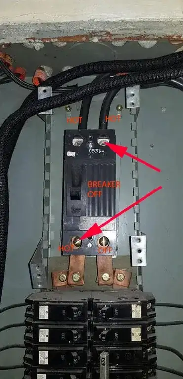

Supposed the breaker is off but the left side is still hot (let's say breaker defective). Won't it work if you measure the terminal in the hot right and load left like in the following picture?
Why won't it work (if it won't work)?

I'll connect two chair lugs to the screws in the above 125A main breaker feeder cooper. If I shut down the main breaker, how do I check both hot wires are gone without any neutral (we don't use neutral since all our equipments are 240v)? A defective breaker may only disable one of the hots. If I use a multimeter, where will I put the other lead on for each?

Between the line and the load on the breaker. You want to test if the breaker disconnects both of its load terminals from its line terminals.

  • How do you test this using a multimeter? If I put the lead between the same side (line and load), would the multimeter be destroyed? Imagine putting it in series between two wires. So I guess one must put one lead in an output on right side.. and put one lead on input on left side? – Samzun Nov 16 '18 at 11:04
    @samzun, with the meter in voltage mode, you can put it on two points with a voltage between them without destroying the meter. Yes, current flows through the meter, but the impedance of the meter in voltage mode is high enough that it can handle it. In current mode, you would likely blow the fuse in the meter. – batsplatsterson Nov 16 '18 at 15:48
  • I mean can you measure the red arrows in this picture? https://imagizer.imageshack.com/v2/1024x768q90/924/CJJDGQ.jpg and then the other sides? Can it check if one of the load side is still on? – Samzun Nov 17 '18 at 10:50
  • Exactly where are you proposing to measure? (It isn't clear to me, and it seems to the OP as well.) – Daniel Griscom Nov 17 '18 at 14:49
  • measure the left load side.. measure the right line side... if the left load side is live.. it can show voltage.. isn't it.. and also the other way around.. see the above picture with arrows again where the multimeter or voltage leads will be put – Samzun Nov 17 '18 at 14:53
