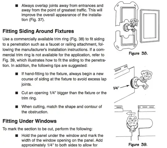

The vinyl-siding manufacturers make special attachments for mounting receptacle boxes, with trim rings to seal against the siding. The attachments are the same or similar to what is used for railings and faucets:
Attachment for outside outlet box
For small fixtures, it is also possible to just cut a hole for it in the regular siding (and presumably seal with silicone), as shown in the following facsimile from the Vinyl Siding Installation Manual:
Do not simply screw the box through the siding as below; it will be very flimsy.

    Minor addendum: Regarding the special attachments for mounting receptacle boxes, the actual term is J-block (which I suppose is a terrible name and explains why it's seldom used)... "vinyl siding mounting block (or box)" is better for searching and finding J-blocks. +Vebjorn because this would be better (for a few reasons) than fitting J-channel around the outlet-hole. – Ben Welborn Jul 22 '16 at 13:55
