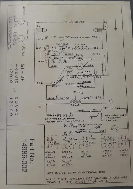

My furnace is old and only has 4 wire connections, but I require a C wire. How can I create one based on this diagram?
I do have 5 wires running between the furnace and thermostat.enter image description here
The way to find a C wire is to look for the transformer, and then find the secondary (low voltage) wire that is not the R wire.
In your case, this is the wire in the diagram going to the right of the part labeled "24 VAC", which is the transformer.
