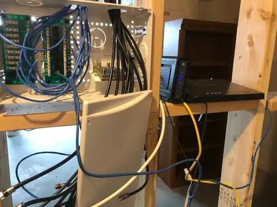

I recently moved into a new home (new build).
Comcast installed my internet, but was of no help getting my ethernet working.
My builder told me the modem needs to be connected in here and then the router needs to be connected to the patch panel for the room I want to have ethernet access for.

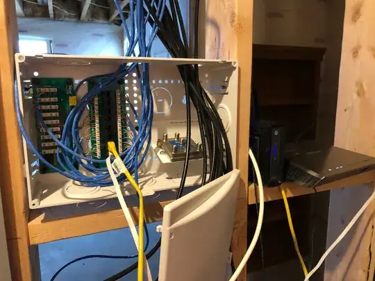

I have connected the cable modem and router. Wifi works fine. I connected the ethernet cables from the port on the back of the router to the patch panel, but I get no lights on the router as you can see and I get no ethernet access.
Not sure what I am doing wrong? enter image description here enter image description here enter image description here
Adding new pictures.enter image description here enter image description hereenter image description here

    Welcome to DIY Stackexchange! What port on the back of the router did you connect to the patch panel? Usually the first one is meant to receive internet, and then others are meant to connect out to devices. Also, it looks like the cable you connected might just work for a couple of the ethernet ports in your house - try all of them, if possible. – IronEagle Dec 06 '18 at 17:32

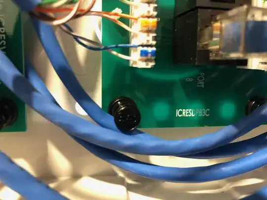

Firstly, and this is just a guess because each manufacturer does their own thing, the wiring in the 568A punchdown block looks like it may be wrong (swapped). You should, if a new build, call the contractor and ask them to confirm the wiring order to the specific patch panel they used.
Assuming your yellow cable is good, and this cable is connected to a room with an actual device plugged in, AND the yellow cable is plugged into a LANport on the router, you should be all set.

Here is the link to the product install guide for the punchdown block. It looks wired right. Are the wired tight? (Use a flashlight, look close, see if the sheathing of the wire has a blade cut through on it to ensure good electrical connectivity): https://icc.com/wp-content/uploads/2017/08/MSR-0411RevJ_DataModuleCAT5eCAT6_Installation_Instructions.pdf

  • Here's what I have: ehternet cable connected to from the modem to the WAN port on my Netgear Nighthawk R7000 modem. Switch ports on router then plugged into the patch panel. I've tried every port on the panel, and I've tried different cables, none of them light up the status lights on the modem that they are plugged in, and in the rooms I've tested the ethernet connection, I dont get a connection. – tydowns Dec 06 '18 at 17:50
    Understood, the R7000 is ONE of my (older) Routers I know it well. You have it connected correctly then. Please, for sanity sake, test the Yellow wire directly to a laptop from the Netgear port, make sure it works. Rules out the cable. What is the white flat RJ45 for? Get it out of there for now as until issue is resolved. As I noted, I think the pairs may be wrong. Please take a closer picture of one punchdown, give us the punchdown block part number, and take a picture of a wall jack in any room, with the cover off and wires shown, – noybman Dec 06 '18 at 17:56
  • Basically it seems 99.9999999999999999999999999% certain your contractor err'd. If it's warrantied I presume it is, get them to fix it. BTW... It looks like it says CAT-5.... not CAT5E... eitherway, I might pitch a fit since theres no real reason to NOT use CAT-6 for permanent wall installation in 2018.... Except cheap contractor getting rid of old CAT-5 CAT-5E – noybman Dec 06 '18 at 18:00
  • Here's a nice writeup on CAT# cables.... https://www.digitaltrends.com/computing/differences-between-ethernet-cables/ – noybman Dec 06 '18 at 18:06
  • tested the cable, it works properly. The cables going into the patch panel are indeed cat5e. Removed the white flat cable. Adding the pics to the original message now. – tydowns Dec 06 '18 at 18:16
  • Just for clarity,since you removed the white flat wire, what is the blue wire plugged into it now? The first RJ45 shown in picture 3 (new #1). Please for now, only work with one port just to avoid complicating troubleshooting – noybman Dec 06 '18 at 18:27
  • blue wire is plugged into a port on the router (not the WAN), and then into the patch panel. Pictures added showing the connection. – tydowns Dec 06 '18 at 18:36
  • Thank you. Can we get a better view of the wall jack end with the cover off the back so we can see if it is a wired right there – noybman Dec 06 '18 at 18:37
  • PS... I updated my post to show the PDF for the panel side, whcih looks good. Just need you to ensure it looks fully punched down – noybman Dec 06 '18 at 18:38

  • Well, let us know what you learn. They may have done 568A one end, B the other, or used a crossover on the wall end... who knows. Given all the troubleshooting steps you did, the 2 last things I would suspect is they didnt use the right punchdown tool and the wires arent electrically connected, OR the wall jack is wired wrong (or wrong tool). Thats the ONLY thing left since you've ruled out your equipment. Let us know! – noybman Dec 07 '18 at 01:14
