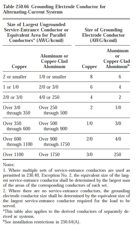

The size of the Main Bonding Jumper, Grounding Electrode Conductor, and Grounded Electrode is defined by table 250.66
NEC Table 250.66

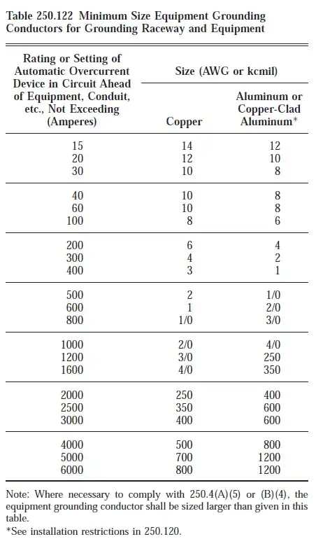

The size of Equipment Grounding Conductors (the ones that run from the Ground bus bar out with each circuit), is defined by table 250.122.
NEC Table 250.122
