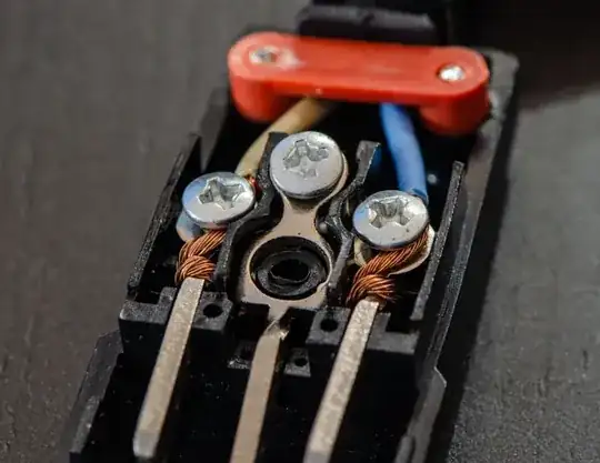

For instance, I suppose the way of connecting the wires shown on the next photo is dangerous, because the connection can easily become loose, is it? It seems that pulling the plug a few times by the wire instead of the plug itself would have disastrous effects on the connection.
Stranded wires are loosely twisted around the connectors of the plug, the screws being relatively useless
If yes, should I solder stranded wire to make it solid? If so, what should I take care of, aside using a rosin-core solder? Once I solder it, how am I supposed to connect it to the metallic parts of the plug?

    The main concern I would have with that plug is the installation of the cord grip. the grip should be gripping on the sheath not the individual wires and it may need to be inverted for a good grip on a thin cable. – Peter Green Dec 24 '18 at 21:47
    I'd like to see it wrapped around the screw a little more; the ends wrapped around the tines do nothing. – Mazura Dec 25 '18 at 19:08
    Thank you for including the picture. This is NOT how it is supposed to be assembled. The screw terminal is supposed to hold the wire under compression and make a good electrical connection. You are not supposed to wrap the wire around the tines like that. Strain relief should be incorporated at the point where the cord enters the plug, so that even if you pull by the cord, no force is transferred to the screw wire joint. – mkeith Dec 26 '18 at 04:03
    @Mazura I don't think the wire is wrapped around the screw at all, it looks like the wire just sits next to the screw. – Dan C Dec 26 '18 at 23:28

  • @DanC -- and it's wrapped the wrong way. Should go in from the left, so that tightening the screw pulls the wire in. As shown, tightening the screw pushes it out. – Pete Becker Jun 29 '22 at 14:52

With that style of terminal tinning the wires with solder is going to cause more problems than it solves.
However the plug in the picture does not look correctly wired to me.
Firstly the wires should wrap around the screws, not merely run down one side of them. They should be wrapped such that turning the screw will tighten the wire around the screw.
Secondly the cord grip does not seem to be correctly installed. It should clamp on the sheath not the individual conductors and it may need inverting to give a good grip on a thin cable or it may not be suitable for thin cables at all. If pulling the cord out puts stress on the electrical terminations the cord grip is not doing it's job properly.

I would not use solder - it won't help the grip much (arguably, stranded wire may actually grip the screw better as it deforms) and while it is probably not a bad conductor, it won't beat copper.
What is important is to wind the wire around the screws in the correct direction. To quote Harper from another answer (and I have seen him mention this quite a few times): Hook the wire clockwise around the screw, so tightening the screw makes it wrap more.
You should not use solder. The flat headed screw is designed to hold stranded wire in place. As other answers said, using solder will prevent the screw head getting a good grip on all the strands of wire and eventually it will work loose.
The mistake you made was to strip too much insulation from the wires and then try to make the joint stronger by wrapping the wire round the end of the pins after it went under the screw heads.
The correct way is to strip only enough insulation to make a loop around the screw, a bit LESS than one complete turn (about 3/4 of a turn is fine) so the wire doesn't overlap itself under the screw head. Wrap the wire round the screw in the direction so that tightening the screw pulls the wire tighter under the screw head rather than pushing it away.
The wires in your picture are coming towards the screw from the correct side, but they don't wrap far enough around the screw, because you thought you should wrap the end around the connector pins instead.

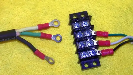

For the particular connection in the OP image, I would suggest using ring terminals on the wire, as they are intended to be screwed down:
image_from_https://tech.txdi.org/electricalconnections
user2813274
  • 211
  • I'm surprised that this excellent answer doesn't have more upvotes, as **this is a superior method than using stranded wire under the screws**. This photo shows insulated ring terminals. Where possible, they should be used in lieu of non-insulated crimp-type ring terminals. However, there is usually nothing wrong with the latter if there's not enough room for the former. – Mike Waters Dec 26 '18 at 19:15
