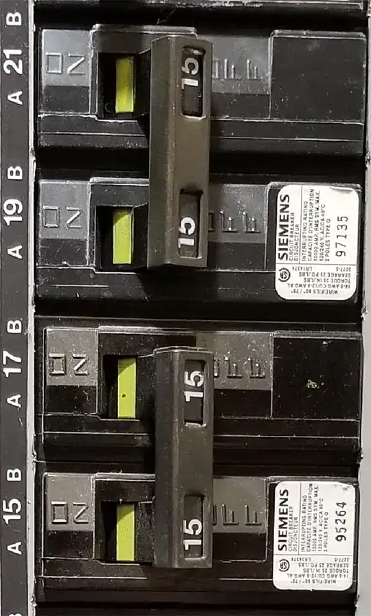

And here are the two handle-tied breakers that supply the four outlets:
Handle-tied breakers

Now, if you need AFCI protection, you need the newer cAFCI breakers designed to work in MWBCs, that do not need the circuit's neutral wire landed on the breaker. (the AFCI may have its own neutral pigtail, this is only to power itself.) These are all 1-pole breakers, so you will need a listed handle-tie to tie them together so they are shut off together for maintenance. This will resemble a 2-pole breaker.

In this case, you leave the wiring exactly as you found it. You will then replace those 2-pole or handle-tied breakers with 2-pole GFCI breakers. In this you land all 3 wires (2 hots+neutral) on the GFCI breaker. You cannot handle-tie two singles because of the shared neutral.
