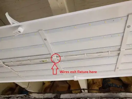

I'm installing 3 LED shop lights in my basement workshop. I've already run new 12/2 NM-B wire to a few junctions and switches, per light. The attached picture is an example of the final splice I need to make.
The cables that come out of the product (both need powered) are quite short and so don't lend themselves to being pulled into a junction box. It may look like there's just enough slack to mount a junction box right on the joist in the picture, but not all of the lights are mounted such that their wires are that close to a joist.
The fluorescent shop lights I'm replacing simply pulled the 12/2 directly into the light enclosure, but these LED lights have no room for that.
Would this be an acceptable place to use the (Tyco, etc.) NM cable splices mentioned in the top answer here? If not, what's the best solution?

Full fixture without the diffuser/cover: enter image description here
Where the wiring exits the fixture: enter image description here

  • @Tyson To clarify, there would technically be room between the top of the fixture and the diffuser cover for splices, however, the cables are intentionally routed out of the fixture, and there's really no way to route anything back into it. Plus, anything inside the fixture would block the LEDs. The pictures I've added to the OP show what I mean. – mmseng Dec 28 '18 at 18:12
  • @SomeoneSomewhere Added pictures. – mmseng Dec 28 '18 at 18:12

What you want is a ceiling box that uses an old-work brace
If you have ever been in a hardware/home-improvement store and wondered why some of the boxes had what looked like a long metal brace attached to them, like so (picture for illustration only):
old work ceiling box w/ brace
wonder no further. That brace is meant to go between adjacent ceiling joists and support both the box and a fixture attached to the box, and the box can be adjusted to position it in the joist bay. The fixture itself then acts as the cover for the box, as per NEC 314.25 and 410.22.
