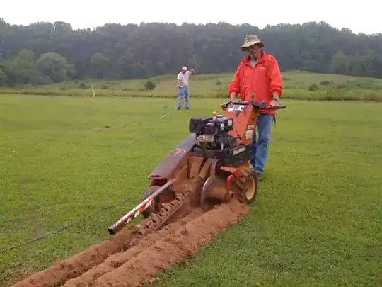

It's physically very difficult to dig a very narrow but deep trench. You may have better luck just renting a ditch digger/trencher, which is kind of like a big chainsaw for dirt. You can dig trenches that are very narrow, and the only thing that really slows you down with it is large rocks.
You should have utilities marked before you dig (whether using a trencher or not). In some areas, this is enforced by law (eg: in Ontario, Canada, it is law under the Ontario Occupational Health And Safety Act).

    Its probably worth mentioning that a trencher will be more than willing to dig through a sprinkler line or anything else that is in your path. That can be slowed you down in having to fix what ever it is that you brake. – Kellenjb Jul 06 '12 at 18:52
    And having a utility company come fix something you cut will cost you fees. Have the area marked! http://www.unitedlocating.com/callcenters.asp – Scivitri Jul 06 '12 at 18:59
  • Thanks I hope I will only need about 12 foot of trench, so will not need equipment this scale. – Walker Jul 08 '12 at 15:55
  • I just checked and these are not commom in the UK and none of my local hire shops have them - they look like a mean bit of kit! – Walker Jul 08 '12 at 16:00
    I rented one of these, wasted my money. Never used one before and the yard was soft from prior days rain. Thing got stuck twice, and it's so heavy that's like a car getting stuck in the mud and wheels just keep spinning. Wasted $200 and ended up digging the french drain trench manually anyway. Sometimes big machines are more trouble than they are worth if you're not experienced with them. I have learned that if it's just a one time job, and you have extra time. You have more flexibility using manual tools and don't have to rely on a time line either when renting equipment. – eaglei22 Jun 06 '17 at 12:53

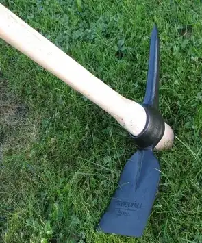

Speaking as one who has done this (or close - my clay was rather hard once you got into it, and it was a deeper and longer trench) I'd strongly suggest one of these; a mattock.
mattock picture from chillingtontoolsonline
Peel off your turf if any, put it aside, use the mattock to break out the clay, use your shovel to lift it over the side. Clear your feet a nice space in the bottom of the trench, and work in it (not DO NOT do this in deeper trenches where you could suffocate if the trench collapsed - in a 3 foot deep trench, you would at worst be inconvenienced for a while until you dug your legs back out.) Keep your standing area cleaned out and clear. You'll need to be somewhat wider than 6 inches to have a hope in heck of digging to 3 feet of depth, IME. You may be able to reach down that far with a long narrow shovel (which I'm assuming your drain spade is) but it's hard to actually DIG when you are that far away from the edge - the leverage is not good.
A small excavator would be much faster, but costly (I've done them that way too) - it's a perfectly reasonable job to do by hand if you'd like to do it that way, and tool rental does not have what you'd like at a price to make it favorable. To keep to the 6" width you'd pretty much have to find a trencher, IME - or you could use a post-hole digger, but that would be more inefficient than digging a wider trench you can work in, IME.
