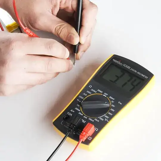

I would recommend looking at the tutorial from SparkFun: How To Use a Multimeter.
It is a bit specific to the multimeter that they sell.
Multimeter reading voltage

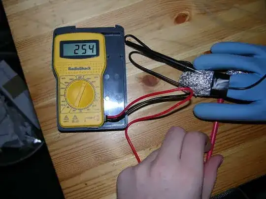

Since you have a Radio Shack Meter try their "Make Electronics" book.
