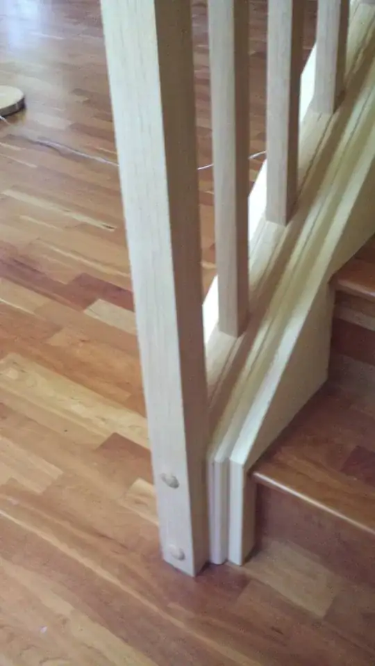

After consultation with my master-carpenter-looking-over-my-shoulder, Dan, the following solution was arrived at:
railing
1.The newel post - built up from 1x3 clear oak boards glued together. Two are full length, one is beveled (before gluing) to sit on top of angled knee wall. Attached by two lag bolts at base and one lag bolt into handrail.
newel
2.Base - shoerail molding (with trough cut out to hold balusters)
shoebase
runs up the angled knee wall. The shoerail is cut into two sections directly below the spot where the handrail meets the ceiling. This will allow the railing to be separated into an upper section, bounded by the base and top rail, and a lower section, bounded by the base and handrail. It is attached with 1 screw in the middle of the upper section between two balusters. The lower section is attached with two screws, also inserted between balusters.
shoebase
3.Top - shoerail is also used at the top in the same manner as the base. Two screws hold the top shoerail to the ceiling (screwed directly into studs at the ceiling/stairwell edge).
top molding
4.Handrail - Standard handrail (with trough) held in place at newel by one lag bolt and at ceiling by one long screw upward into stud.
handrail
5.Balusters - These are toenailed into base shoerail and top shoerail. For extra strength, blausters are glued before nailing (Nailholes will be covered by fillet pieces).
6.Fillets - these are the filler strips put into the shoerail moldings top and bottom to lock in the balusters. They are nailed into place after the balusters are inserted in the shoerial. The fillet peices that sit over the attachment screws, top and bottom, are not nailed in, but held by small recessed screws so that the can be taken out.
fillet
All nailing was done with an 18 gauge nailgun.
Removal involves
a) unbolting the newel post,
b) removing the newel post,
c)removing the fillet pieces covering the screw holes in the base and top shoerails,
d) removing the two screws holding the lower shoerail base in place,
e) removing the upper handrail screw at the ceiling,
f) removing the lower handrail/base/baluster assembly,
g) removing the two screws holding the top rail,
h) removing the screw holding the upper section of the base rail,
i) removing the upper top/base/bauster assembly.
