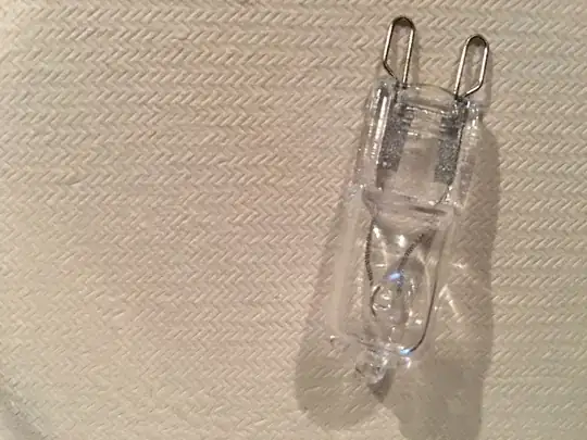

This bulb is found inside a fancy light fixture, I haven’t seen one before and it doesn’t have any markings on it. I need to order replacements.
More images showing the context of where I found this bulb.

    Looks like [B pin lamp base 9G](https://en.wikipedia.org/wiki/Bi-pin_lamp_base) – bummi Jan 08 '19 at 20:26

It's a "G9" base Halogen bulb.

    Just to add: If you use a G9 base halogen (instead of a G9 base LED substitute), be sure not to touch the glass, as the fingerprint may lead to uneven heating and subsequently cracking of the glass, which is a [fire hazard](https://www.bulbs.com/blogs/light_source/post/2010/10/18/Quartz-Halogens-Handle-With-Care!.aspx). To replace the bulb, place a cloth between your bulb and your fingers. – henning Jan 09 '19 at 14:02
    You can wipe the bulb with alcohol to remove any residue from touching it. – Jonathon Reinhart Jan 10 '19 at 03:39
  • @henning TIL the reason - I always knew never to touch these bulbs but never knew why. – Muzer Jan 10 '19 at 12:12
It's a halogen (identified by mike65535 as a G9). You'll want to find voltage and wattage markings for compatibility. Using bulbs with too high of a wattage rating can create a fire hazard.
