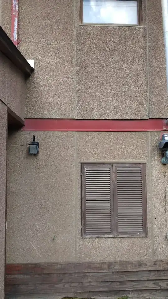

I need to paint the exterior walls of this house, but I am not sure what is the material of the walls.
I know this type of houses came from Finland to to south of Argentina because they are excellent for very cold weathers.
Also I would like to know if I have to use latex paint and/or washing first with soap and a pressure washer machine (like the one uses to wash cars).
a picture of the house another picture of the house one more picture of the house

  • I think that's exposed aggregate concrete, but I don't know any special methods for painting it, I'd think just a brush or a very nappy roller. – batsplatsterson Jan 25 '19 at 14:50
  • Pebble dash is the look of it but yours appears to be precast panels of concrete with the exposed pebbles. Is that a vinyl channel between the panels or caulking? – Kris Jan 25 '19 at 14:54
    It's not always a good idea to paint masonry or stucco. Some of it needs to breathe to avoid damage, mildew, etc. – isherwood Jan 25 '19 at 14:56
  • http://www.kerkstra.com/architectural-panels.html. Something like this company makes – Kris Jan 25 '19 at 15:06
  • @Kris They are panels of 0.5 cm and the unions have silicone caulk. It seams to be something like cork with pebble. – Roby Sottini Jan 25 '19 at 15:45
  • @batsplatsterson it isn't concrete because it is a flexible and light precast panels that came by boat from Finland to Argentina. – Roby Sottini Jan 25 '19 at 15:52
  • I thought exposed agregret panels also, maybe a better photo is needed since several thought the same thing, edit the composition into your question or there will probably be others that miss the cork part. – Ed Beal Jan 25 '19 at 20:50
