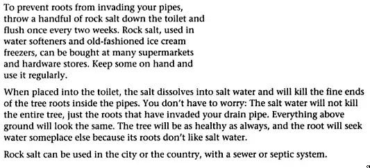

I was able to find a reference to this in chapter 22 of The Complete Idiot's Guide to Household Solutions.
excerpt from "The Complete Idiot's Guide to Household Solutions"
Though honestly, I've never heard of this approach until now. I'm no expert on the corrosiveness of salt, but I would imagine the levels of salt in the sewer would not be high enough to rust the pipe. I'm also skeptical that the salt levels would be high enough to completely kill and prevent the roots. While I wouldn't recommend pouring a bag for rock salt down the drain, a handful once or twice a month will probably not hurt the pipe.
