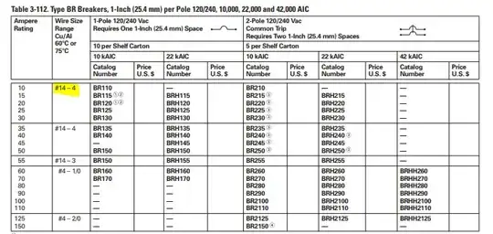

The Eaton catalog clearly says that the breaker can accept anything between and including #14 - #4 AWG.
You should follow the instructions that tell you to use #10, as it will fit the breaker, and will be appropriate for the amps you are running.

3It should be noted that the chart covers all type BR, 1 inch breakers. It isn't specific to the 25 Amp version. – isherwood Jan 30 '19 at 16:28
4True. The #14-#4 range is for breakers of 10-50 amp ratings. It indicates to me that they just use the same terminal on all of those, which accepts wires within that range. It's up to you to select the wire that falls within that range AND that is rated for the ampacity of your application, right? – PhilippNagel Jan 30 '19 at 16:31
No, no, no...
The breaker isn't saying it's for "14/2" Romex cable. It's saying the terminal is able to physically attach #14 through #2 wire.
Whereas the 14/2 cable designation means it has #14 wire and 2 conductors (in house cable ground is counted separately, in cordage it is not).
The ability to fit #14 or #12 is irrelevant to you, unless you are mounting the breaker inside the chassis of a piece of equipment that is not part of any building, or your wiring is being done in a very special set of circumstances unlikely to be seen outside an industrial setting.

Possibly #14 copper wire could be used with a 25-A breaker if it was dedicated to supplying certain loads in which the momentary starting draw was above 20 A, but the running amperage was well below 15 A, e.g., 12 A. But for general use a circuit protected by a 25-A breaker would be wired with 10 AWG copper wire. Follow the instructions for the load you have and use #10 copper wire.
Any statement on this 25-A breaker or in an accompanying leaflet about using #14 wire, must actually be a warning that #14 is the minimum size wire under any circumstances. It cannot be a statement that #14 is allowed in general.
