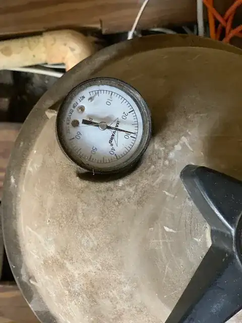

    Air bubbles are a leak on the suction side of the pump and don’t have anything to do with the pressure being high. Where is the pressure being measured? If it’s a gauge on the filter is the filter clean? What type of filter is it? – Tyson Feb 02 '19 at 19:11
  • @Tyson filter is clear. Pressure is being measured via the pressure gauge on the filter. – TheCodingArt Feb 02 '19 at 19:32

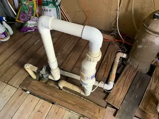

  • The flow rate of the new pump may just be higher than that of the old. As you know the pressure gauge on the filter is there to tell you when to clean or backwash the filter. As the filter becomes plugged back pressure increases. Same thing implies to increased flow from a better pump, if water isn’t pipped away fast enough back pressure is the result. As for the air bubbles, they are getting pulled in on the suction side, you mention diverter valves but don’t tell us the choices.. I assume they are all suction side? – Tyson Feb 02 '19 at 19:41
  • There’s a diverter valve on the return side for the pool and spa. I was referencing the suction diverters above. There’s on combo for pool and spa, then one for cleaner and the vacuum. I’ll update the question with a picture. – TheCodingArt Feb 02 '19 at 19:47
  • @Tyson added pictures – TheCodingArt Feb 02 '19 at 19:56
    Suction side leaks result in air bubbles, pressure side leaks are pipe dribbles. The union where the pump connects would be my first guess since you took it apart, don’t over-tighten it tho instead clean/replace the o-ring and where it seats and add magic lube or non-hardening plumbers paste. If it’s an underground leak you can isolate that with suction side diverter valves (I bet it’s the o-ring on the pump union tho). Increased pressure is probably higher flow rate on new pump, is it variable speed? If so, just slow it down. – Tyson Feb 02 '19 at 20:10

  • If air is being expelled getting in somewhere on the suction side. I can’t tell much about what valves actually do what from pictures. – Tyson Feb 02 '19 at 22:55
  • Sorry, I’ll upload better quality ones. It’s pretty much what I was noting before though. Suction on the pool, cleaner, spa, skimmer. – TheCodingArt Feb 02 '19 at 23:00

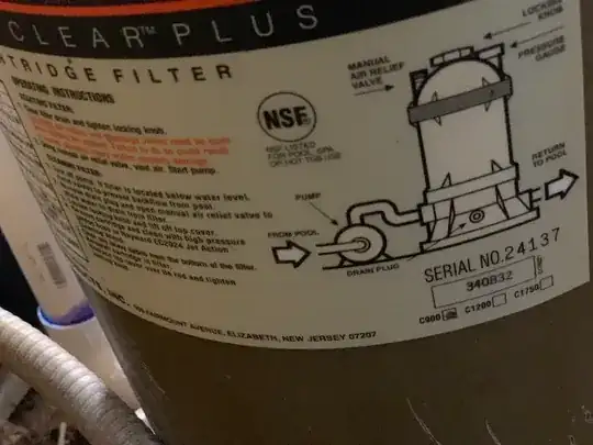

2 hp is WAY too big for that system. That looks like a 90 sq ft cartridge filter (C-900) which can handle up to 90 GPM when clean but that is extreme. 25-30 PSI is probably not out of the "normal" range for 2 hp. You don't say how many gallons the pool is but that should determine the size of the pump. You get far more efficiency and better filtration with a slower flow. General rule of thumb is smaller pump, larger filter. More power is not good when talking about pool pumps. In addition, it looks like your piping is 1 1/2" PVC. You can only force so much water thru that small of a pipe. Think of trying to blow a mouthful of water thru a soda straw. You will encounter pretty substantial resistance. That's a small version of your pool pump...that resistance, called "head pressure" or "friction loss" converts to PSI at the pressure gauge.
The real solution is to downsize the pump. If you don't want to spend the money since this one is new, you can refit it with a smaller impeller, maybe a 1 hp impeller. For a Super Pump (with the square lid) that would be SPX2607C. If it's a round lid, then it's a Super II and would call for an SPX3007C.

  • I purchased a 125 square foot filter to plug in and want the higher hp for my own reasons. With that being noted, the intake has 2 inch pipes. Return lines are 1.5 inch. The current is 90 square feet which identifies right around the GPM calculation for the pool size (around 23,000 gallons) rather above the calculation like it needs to be – TheCodingArt Feb 07 '19 at 16:25
  • Removing the filter places the psi at 15, which indicates the pipes should be fine for the flow, but the filter is a blocker – TheCodingArt Feb 07 '19 at 16:29
    A clean cartridge should run between 8 and 15 psi. No cartridge should run less than that. A 23,000 gal pool should circulate around 32 gpm for a 12 hour turnover, Even for and 8 hour turnover, you only need 48 gpm. Think about what your telling me...your pulling water in thru a 2" Pipe and pushing it back thru a 1 1/2" pipe. That's like squeezing 2 lanes of traffic into one lane...you're going to have a backup! (i.e. more pressure) BTW an 2 hp pump would not even pass inspection in my state unless you're using 3 inch pipe! – Hank4Pools Feb 15 '19 at 12:34
