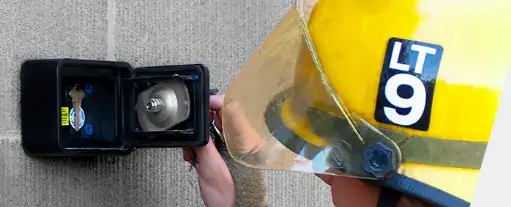

Call your local police department and inquire about a "Knox Box Key". They probably have a master already to open one. You will need to buy the one they suggest or have a locksmith get involved to match their key to the box you purchase. They might even have a system set up for your community that you don't know about.

The least expensive solution here is to buy a combo lock key box. You place a key to your home inside, put the box somewhere accessible outside and, if you call 911, you simply provide them the location and code. Just be sure to reset the code between uses.

    RE: the low security, yup IOT security sucks, but in this case it does not suck much more than the alternatives. Knox boxes are trivial to open if you know how and combo key lockers were known as the worst security hole on the market until IOT locks came along. – hildred Feb 04 '19 at 18:19

At our home town, the Police, Fire, and EMT have a program that address this. At one's descretion, a home owner can leave a copy of the door key and/or PIN code, secured at the station, andt used in an emergency. No waiting for beaking doors or windows.

In my rural fire department you either give a key to the fire chief, who tags it and locks it inside the keybox of a response vehicle, or you give the alarm company (if you have one) or the chief the location or code (or both) for your spare key, or the contact info for your choice of a local "keyholder". Of course, almost nobody here locks their doors anyway, rendering it a moot point in the majority of cases. Obviously, if you're conscious when calling 911, you can also give instructions on which unlocked door to use or where the key is for the locks. Also, each engine has one or more sets of tools for making a forcible (but fairly graceful) entry when justified by the perceived risk of unnecessary delay.
