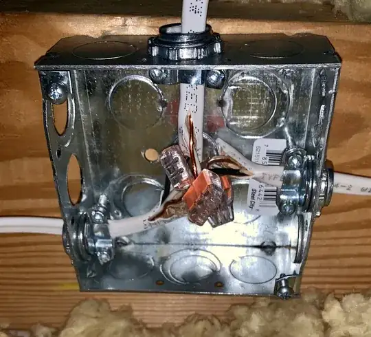

This my first attempt at a junction box . I am kind of worried the wires are too short. They are all in the push connectors. Is this safe?enter image description here

    looks way too short ..... you should be able to pull the ends of the wires out of the box and work on them comfortably – jsotola Feb 11 '19 at 18:56
    Those wires are so short that you are actually at risk of a wire or junction break -- especially if that space is subject to freezing temperatures. – Brock Adams Feb 11 '19 at 23:25

    I'll add, since I haven't seen it below, that in the places I've done home wiring (Ontario and Nova Scotia, Canada), the excess _external_ insulation is a problem. Shouldn't be more than a cm or so from the cable clamp (I don't have my simplified code with me to get the exact amount. – Auspex Feb 12 '19 at 15:56
    In the UK, I would add some green/yellow earth wire insulating sleeve on the exposed bare copper. Not sure if this additional safety measure is used in the US. – uɐɪ Feb 12 '19 at 16:07
    @uɐɪ In a metal box that would be undesirable. The point of bare ground is to provide maximum exposure to this extra path. In fact, you're required to attach a ground wire to the box. – Machavity Feb 12 '19 at 19:21

    The box (if metal) has to be earthed in the UK too. We brits sleeve the earth wire for identification and to stop it accidentally touching terminals on accessories. – Peter Green Feb 13 '19 at 00:25

The work is solid with a few exceptions.
Yes, that's too short. You should be leaving 9-12 inches. The legal minimum is 6" past the clamp, or able to reach 3" beyond the finished wall surface. It can seem cluttery, but cluttery is good.
Are you using a book on electrical? The book would tell you this. People learning electrical work best when they have a general overview of all aspects - a primer if you will. Google can't substitute because Google only answers questions, and without a well rounded set of concepts, it's hard to know all the questions you should be asking.
You will need to replace all three legs, and you will be better off doing it now, rather than waiting until the drywall is up, you are doing any kind of maintenance, and you are forced to improvise. Remove the old cables carefully and you can reuse them - maybe even for each other.
These push connectors are particularly problematic with short wires, because it is annoying/difficult to wrest the wires out of the push connectors, so people usually just snip them. You'll want even more length for that.
Some people get snipper-happy and go out of their way to cut wires as short as they can. Perhaps they think there are brownie points for that... Code does mention "neat and workmanlike", but functionality and maintainability come before neatness. Another trouble spot is the panel - it's in vogue to go snip-snip*, but for maintainability, you should give every circuit enough length so both hot and neutral can reach every breaker position in the box.
You need to ground the box also. Most boxes have a threaded 10-32 hole in the back for a ground screw. Some are on dimples so they work flush against a surface, look for that feature in boxes. They sell special green #10-32 ground screws. But any will do. Do not use a deck screw or sheetmetal screw unless it is cut -32 thread or finer.
Rather than spend a big budget on connectors, I would recommend using wire nuts instead. Not least because you can take apart wire nuts and reassemble them. But even more, because wire nuts produce reliable connections, and push connectors - like any backstab - are notorious for series arcing and failure. At least you are in a metal box, which will contain all but the worst series arcing.
I also see where you have knocked out two additional knockouts. You need to fill those with knockout plugs. Those are trivial cost, about a buck for five. Alternately, if you are expecting more cables to come in, you are painted into a corner with those push connectors.
Assuming you'll have 5 cables, it's time to start talking about box fill. If the box is getting too crowded, you can get either box extensions or "mud rings" which provide some additional cubic inches. On the Web there are "official" tables and calcs for box fill, but if you are leaving yourself 9-12" of wire, you'll know when boxes are getting crowded. The takeaway is that extensions (and larger boxes) are available.
My signature box when I have >5 cables converging is the 4-11/16 square x 2-1/8 (120 x 55mm) which I buy at electrical supply houses, where they are much cheaper.

I'm no electrician, but at first glance I would say two things:
  1. Ground the box itself. That ensures that there's no chance the box itself can become energized, because if a hot wire ever touched the box, it would trip the breaker. Unlikely situation, but I always do that when I'm working with metal boxes just to have some peace of mind. You should be able to do this with a common ground screw.
  2. Plug those open holes unless there are more wires going in there. You can buy little knockout plugs for less than $.50 at most home improvement stores. Open holes into a live electrical box are never a good idea.
In the future, I'd leave a little bit more extra wire in there, but it should function just fine assuming you've used the correct gauge wire for your current rating.

    It's worth noting all of these, including the wire length, are required by code. Metal boxes must be grounded, unused knockouts must be covered, and the wire must be able to extend at least 3 inches from the opening (6 inches of extension if all dimensions of the box are at least 8 inches; 6 inches is a general rule is typical). – GManNickG Feb 11 '19 at 05:31
    Also, use screw terminals, they're a lot safer and more reliable. – Dan W Feb 11 '19 at 18:22

In addition to everything else everyone's said, if you don't have any spare length in the wires, it limits your ability to make changes to your wiring later.
You would struggle for example to bring in a 4th wire, and you've no spare length to correctly wire the earth wires to the metal box.
You may also need a little slack if you later adjust another fitting, or split a wire to make another spur off the ring.

  • Concur - OP or some other future person is gonna be grumpy if they need just a little slack somewhere in a wire. – Criggie Feb 11 '19 at 23:04
  • Yeah, I’ve done that to myself, had to re-run the wire because I’d not left a couple of inches slack. – Dan W Feb 11 '19 at 23:07

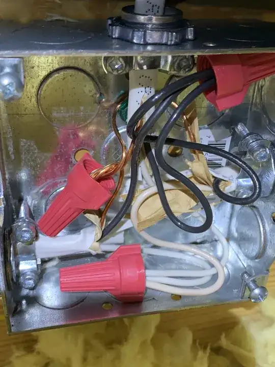

Looks ok I think it will work just needs a little sprucing up .
Providing your cable runs are long enough you may want to insert additional cable into the metal box, if you do. Strip back the cable sheathing within the metal box at least 6inches then connect them to the push in connectors ,also ground the box itself either by adding an additional bare wire to your connector if it is a 4slot type connector if not then loop an existing ground wire clockwise to the ground /bonding screw sometimes they are green .
Also reverse all of your clamps have the screw portion of the clamps on the outside of the metal box and then use knock out plates to cover the two spaces on the left side of the box.
Antwan
    Thanks for the tips. I added more slack along with wire nuts. I added a ground screw and wrapped the main line ground around it before splicing. I got the wrong size knock plugs so I will put those in tomorrow. – Dyielectric12 Feb 12 '19 at 01:16
