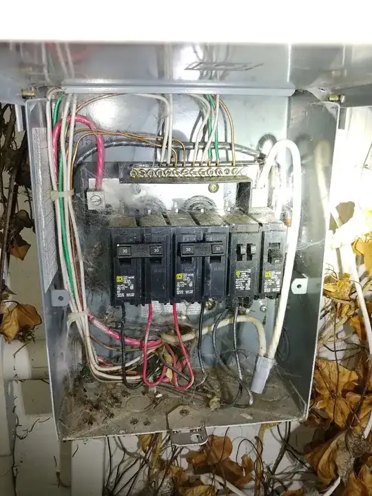

  • Current load center. The panel is exactly opposite the meter socket right now on the inside of the house. breaker detail existing panel 2 Breakers wiring detail
  • The Exterior Subpanel breaker is connected to this indoor-panel-mounted-outdoors-without-a-cover subpanel outside. enter image description here The first two 30A double pole breakers are hooked up to the water heater and the oven. The rest are unknown. I assume one goes to a sump pump; not sure where the other ones lead. I have some random outlets mounted to trees on my property from conduit that comes out of the ground; perhaps it's one of those.
  • Central Heat Pump. Sorry for the spiderwebs: Central Air Handler Outdoor Unit
