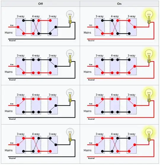

This is how multiway switching works.
These are US friendly colors (regardless, colors tend to be a big mess in multiway circuits). Note the funny switch in the middle; it is different from the switches on the ends. The diagram may be a little unclear, the switch in the middle has 2 positions, either straight-thru or effectively switching the wires.
There can be any number of middle switches. Each middle switch either reverses/exchanges the two wires, or sends them straight through. All wires are always connected.
So yes, a middle switch in a 3+ switch run will be weirder than the end switches.
