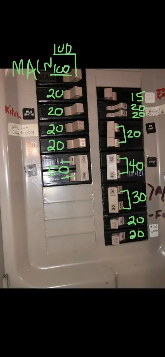

Edit: Is this panel overloaded? I'm counting 130 on left and 165 on right. Shouldn't it be below 200 total?

The number of spots open waa actually only the bottom 4 on the left. The top two were where the main power came in.

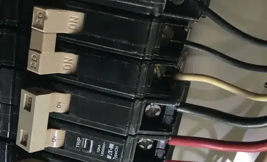

  • Another thing to look at is the two wires on that double-stuff breaker. Since they are going to the same destination, I wonder if they are a *multi-wire branch circuit* (shared neutral) -- if so, one wire will be red and one black. For them to both be on the same double-stuff, **that would be bad**. It would mean they are on the same *pole* and that means the neutral would be carrying the sum of both currents rather than the difference, which would overload it. – Harper - Reinstate Monica Feb 20 '19 at 21:54

At that point, you can take the existing 14/2 homerun off the existing 20A breaker in the panel and land it on a new 15A breaker fitted in one of the open slots on the bottom left -- Eaton CH breakers are widely carried by big-box stores and supply houses across North America. (If you need to splice some extra 14AWG onto the end of the homerun to make it reach, go ahead and do so with a wirenut -- splicing in a panel is safe and Code-compliant, even though some ignorami misinterpret the Code that covers this to say otherwise.)

On the breaker panel being oversubscribed, that's not actually a problem; they're supposed to be oversubscribed because not every load will be on at the same time.
As far as balancing the sides, actually sides work quite differently than you'd expect. This answer illustrates it. You have to count alternating rows, and count a 2-pole breaker as being in each row. That one in the upper right is not a 2-pole, but the linked answer discusses what it is. Both its breakers count as in the same row.
That is an excellent industrial grade panel, and I would keep it especially since you seem to have some spare space. The only problem I note is a 40A breaker allegedly for a dryer. Unless your dryer is very unusual, it should be a 30A breaker. In particular, dryer wires are usually 10 AWG, and 40A would overload them.
Panel capacity is not based just on the ratings of the breakers plugged into it, meaning that you don't simply add up the numbers on the handles. There is what's called a "diversity / demand factor" that is applied based on knowing that not everything it going to be running at full capacity all of the time. It's not an easy subject for the average DIYer, but it's highly unlikely that adding one more 20A branch is going to be a problem here. Think about it, you are not actually adding LOAD, you are spreading the same load out among more circuits.

  • Adding the circuits would be beneficial for the future remodel. However, I am uncertain about the panel capacity for adding breakers. Is there a max of breakers I can add to my panel? (I added a couple photos) – Valerie Feb 18 '19 at 17:47
  • You are not adding new loads just moving outlets that exsist to a proper sized circuit so adding won't be a problem. It looks like you have 4 open spaces on the bottom left and 1 in the upper right, more than enough to make a couple of changes. if properly sizing that 20 amp to 15amp because of the #14 wire causes the 15 amp to trip some of those loads can be moved. You have a good panel and those breakers are inexpensive. – Ed Beal Feb 18 '19 at 18:43
