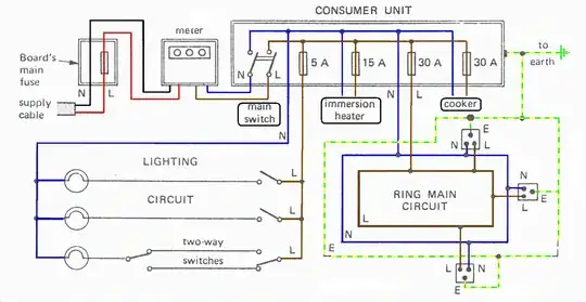

A wiring diagram or electrical schematic usually shows each connection using sometimes cryptic industry symbols and with no routing information. They may be too detailed for your purposes, and they wouldn't show how the cables run through the building.

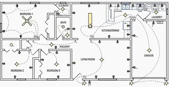

An electrical plan or wiring plan would simply show how the cables run through the building and what each cable's specs are (14/3, 10/2, etc.), possibly along with device notes (outlets, switches, utility appliances, etc.), and without showing each individual connection. This may be what you're describing.
