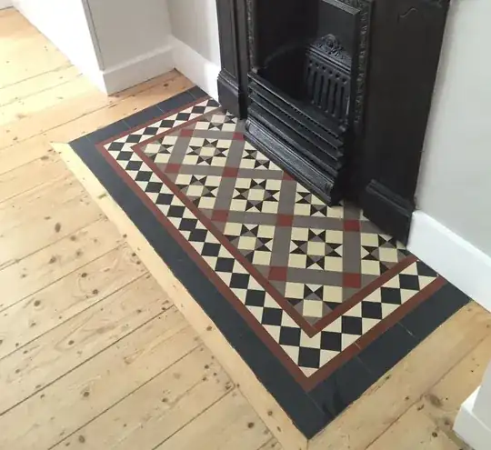

Mosaic tiles on hearth I would like a mosaic tile hearth similar to this.
The existing hearth is uneven and has cut outs in the corners. It lies approximately 1cm proud of the wooden floor, and extends back into the fireplace recess.
Should I:
  • remove the old hearth completely and pour a new base for the tiles
  • somehow fill and flatten the old hearth and cover with the tiles
Any other suggestions or comments are welcome.
