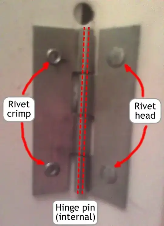

You might be able to remove the hinge pin by gently tapping from the bottom up, using an appropriate size punch and hammer. The photos don't show the top and the bottom of your hinges well.
If the hinge pin is flanged at both ends (like a nail head), then you won't be able to do this, though.
Otherwise, you'll have to remove the rivets...
You could try drilling them out, but take care not to damage the hinge and/or the mirror frame.
Likewise, you could take a Dremel cutting wheel and carefully cut off the rivet crimps (See the image below).
But, for small jobs like this and with small soft-ish rivets, I've had good luck just mashing the rivet-crimps with vise-grips and/or diagonal cutters -- squeezing it small enough that the rivet could be pushed through the whole. If the rivets are not too tough, this can be the fastest and cleanest way to get them off.
hinge and rivet parts
Note for completeness: In some cases, rivet crimps and/or heads can be chiseled off, but in this case, it would probably wreck your cabinet in the process.

My vote is for careful/judicious use of a 4" angle grinder. I'd grind about 80% through the exposed rivet heads and then apply a prying force to break the remaining steel.
It won't take very long! a few seconds per rivet If you're right handed, start with the rivets on the right face: That's a more natural/controlled way to hold the grinder. A brand new grinding wheel has a more precise grinding edge for precise control Be careful not to grind the painted surfaces Try not to grind anything except the rivets themselves Use pop-rivets or machine screws with nuts to re-assemble.
