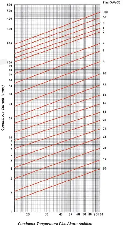

To give this question some perspective, let's consider a chart. This shows how hot your wires will get for a given AWG size and current.
If we follow the 12AWG line, which is required to be protected by a 20A breaker, we see that the wire will heat to about 10C above ambient (ie: ~32C in normal room temperature, or 90F for those who refuse to join the modern world) when carrying its full rated load of 20A
If we follow the 8AWG line, which must be protected by a 40A breaker, we see that it too will heat to about 10C above ambient when carrying its full load current of 40A.
If, however, we follow the 12AWG line out to where it crosses 40A, we find that the wire will now heat to 60C above ambient, or 82C (180F) in our standard room when overloaded to 40A. This is not trivial.
The temperatures below, further, are for single insulated, "free air" cables. In a house you will certainly have double-insulated wire and it will be stuffed into walls, through insulation, and in all types of other circumstances that will only make this situation worse.
Use the right wire gauges - always. It's not an option and it's not a nervous-nellie fearmongering story about burning your house down - the difference is dramatic. Rules are there for a reason.

  • I don't see where you are getting a 10C rise at the rated amperage. The 8G wire looks like its either 0 or maybe 1C at 40A and the 12G red line doesn't even show up on the chart until 20.5A or so. – JPhi1618 Mar 14 '19 at 14:51
  • 60°C above ambient is acutally less than I would have expected, things might not catch on fire. (still not save though) – Christian Mar 14 '19 at 16:02
  • @Christian Again, this is for free-air single conductors. Inside a wall, run along with other cables, with two conductors inside a sheath both overheating next to each other, the actual temperature rise would certainly compound to a value significantly higher than this "best-case" test where the cables can freely shed heat unconstrained. – J... Mar 14 '19 at 16:18
    @JPhi1618 The chart starts at around 10C (maybe closer to 15C, actually) - it's a log plot with temperature, there is no zero. – J... Mar 14 '19 at 16:19
