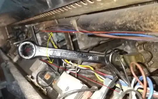

Working on the propane conversion of my gas stove. One of the orifices to be changed is in a very hard to access location - shown in the photo. The orifice is the "nut" I'm referring to, which you can fit a wrench onto.
Although it is possible to get a wrench on it there is a very limited range of motion due to surrounding apparatus. I've tried to mark this in the photo with the red lines. The very short arc that the wrench can turn in means that it never gets a 'bite' on the orifice / nut and I can't even loosen it.
It would be much more work to disassemble the other parts in this area, so I'm hoping for a solution to remove and then reinstall just the orifice part. Maybe there's a specialty type of wrench... or something else I'm not thinking of.

    Before going to buy a new tool, have you tried turn the wrench over? I’ve had places where I kept having to flip the wrench to get in on the nut. – UnhandledExcepSean Mar 17 '19 at 14:39
  • @UnhandledExcepSean yes, it won't start the fitting turning either way. Too much play between the wrench & contact surfaces. – StayOnTarget Mar 18 '19 at 09:46
    Is that the gas valve? Can you unbolt it and swing it out of that area, looks like the line is flexible. – Platinum Goose Mar 18 '19 at 15:56
    "Get a cheap and nasty dollar store wrench, and file and bend it into submission till it fits" an acceptable answer here? :) – rackandboneman Mar 18 '19 at 19:29
  • Obviously you need a bigger hammer! – Hot Licks Mar 19 '19 at 01:48
    Ah, welcome to the bane of every car mechanic's existence! – Clonkex Mar 19 '19 at 05:51
  • @DaveInCaz `Too much play between the wrench & contact surfaces.` In that case, the wrench probably isn't the right size. Looks like you're using metric; try imperial. Also beware (general hazard of gas) that over tightening can be as bad as under, as the fitting can crack and leak. According to 'Why Buildings Fall Down' (read as a teen, I remember it being quite interesting), this is what brought down Ronan Point. – Mark Mar 19 '19 at 17:17

A Crowfoot Wrench would work nicely. A 10 piece set of these is only $15.00

    There's a sub-type of crowfoot called the flare nut crowfoot wrench. It may (or may not) work better in this application. – Greg Hill Mar 18 '19 at 17:46

I'm a gas fitter and service tech. My bag has the tools to do the job. Sometimes these tight spots require a bit of a turn with one tool and a bit of a turn with another. A lot of the available arc can be chewed up by lash, torsion and flex of components. The first tool I'd reach for, for something like this is a line wrench. I'd get a 12 point enter image description here Amazon
After all, this is the tool made for this job
If that didn't work it's the 6" or 8" Knipex Cobraenter image description here Home Depot
These are amazing and are designed to avoid stripping and marring.

What you may be overlooking, or what may not be present on your wrench, is the the open wrench is not square to the shaft. It is canted by 1/24 of a circle (15 degrees).
As a result, there's a 30 degree difference between the wrench (normal) and (flipped).
That means you only need a 30 degree arc of motion, not a 60 degree arc. When you run out of travel, remove the wrench, flip it over, raise it 1/12 of a circle (30 degrees), and it will fit on the next flat.
If your range of motion is being compromised by the wrench being all loosy-goosey on the nut (that's a technical term), then you have the wrong size wrench. Do not proceed further because you'll damage the hex corners, which will make the lash problem much worse. In particular, watch out for English vs. Metric. The only wrench sizes that match up are 3/4=19mm, all others will be sloppy.
An adjustable wrench (commonly called a 'monkey wrench', inaccurately) is one answer, but you have to get that tight and might have to retighten on every turn.
It certainly looks like you have more than 30 degrees of motion there (though perhaps not quite 60 degrees). If you are tighter than 30 degrees, first stop and think about how the manufacturer intended this thing to be serviced, because not least, they had to build it and they certainly didn't want their factory workers spending 10 minutes fastening this one thing. If the range of motion is simply impossible, then you need the extreme options offered by others, or perhaps a "stubby" (short length) wrench that allows you to work inside the obstructions...
    It could also be a cheapo wrench that is not very precise in its size. I'm going to try some other wrenches & other sizes to see if any get a better grip. I'm not sure if there is enough space for an adjustable but we'll see. – StayOnTarget Mar 18 '19 at 09:47

    @DaveInCaz my other concern would be whether you're using an SAE wrench on a metric nut or vice versa, since you mention slippage. Certain sizes in SAE/metric come *very* close to one another, but if you use the wrong one it'll feel almost like it fits except it's a bit sloppy. – Doktor J Mar 18 '19 at 21:35

The best tool I have found for the type of application you are working with is a 12-point split-box wrench. These are also available in a 6-point design.
(Picture Source: http://constructionmanuals.tpub.com/14256/css/Types-and-Uses-Continued-156.htm)
The split end lets the wrench get onto a fitting even when a tubing is inline. The box construction also gets better grip on the fitting than trying to use a conventional open ended flat sided wrench. The 12-point design and ability to flip the wrench over if needed from stroke to stroke makes this the tool of choice if the working angle to the fitting is small.

An open end Ratchet wrench is likely the best tool for this job.
Something like this: enter image description here

One solution I have is a set of wrenches with angled heads - you can see one end has a greater angle than the other, very handy in many situations :

    I don't see how that does anything at all for your range of motion. I'm assuming the builders of that tool were smart and made those two heads 1/12 of a circle (30 degrees) off from one another. But that just means you need to flip the tool end from end every 1/12, whereas with a normal wrench you just turn it over. – Harper - Reinstate Monica Mar 17 '19 at 17:07
  • If you don't have them to use then you won't know... – Solar Mike Mar 17 '19 at 17:11
    Maybe you can explain how you use this type of wrench to solve the "I don't have 30 degrees of arc" problem, which is OP. Because attaching to the next hex around doesn't really do anything for that problem. Do you alternate between this and a normal wrench? – Harper - Reinstate Monica Mar 17 '19 at 17:23
EDIT this won't work because in this instance the fastener is obstructed by a pipe. Leaving for completeness.
There appears to be plenty of width to the slot. How about a socket with a long extension bar and a universal joint?
They add slop but that's no more than annoying. You'd require a deep socket to go over any bolt too.

Try an open-end ratcheting wrench. Here's a video showing how they work at about 30 seconds into it; manufacturer demo and not intended as an endorsement:
https://www.youtube.com/watch?v=QWBlQdporxE
I would try with my socket set and ratchet handle. If there's enough space to get the socket and ratchet over the nut, then you need only a few degrees of wiggle at right-angles to the nut in order to un-do it one click of the ratchet at a time. (Also you can be sure of getting the nut back on, whereas if you get it off with an open wrench of any sort, this may prove to be a problem!)
I have seen the equivalent of a ring spanner with a ratchet mechanism built in, which is hardly any thicker than any standard wrench. I have yet to need to buy one, but it's probably the ultimate solution to such a problem. This is an example:
Before anybody points this out: ratchet mechanisms are "weak". They do not allow one to exert really high torque, and tend to fail if you try to dislodge a really stubborn nut, for example by bashing the handle with a hammer. If this is a problem, start with a standard wrench to loosen the nut a little. Then switch to the ratchet.

  • If it were possible to fit a socket on to the "nut" then this might work, but the "nut" has a pipe coming out of it (just visible behind the spanner in the photo). – Andrew Leach Mar 20 '19 at 08:59
  • I share your pain. Sometimes I think the design brief is to make the hardware as hard to repair as possible (built-in obsolescence by expense of repair). I googled "open-ended ratcheting spanner" and such a thing does appear to exist, for example https://www.audel.com.au/toptul-aeat2222-open-end-ratcheting-wrench-22mm/ ... but unsurprisingly, such a specialist tool is not cheap! – nigel222 Mar 20 '19 at 09:25
I suggest the wrench is the wrong size for a perfect fit on the nut. Plumbing fittings are commonly made in their own peculiar series of sizes. Just a little misfit at the nut becomes a large loss-of-movement at the handle. Suggest you explore the fit. If it is desperate, you might be able to shim the wrench for a neat fit on the nut.
