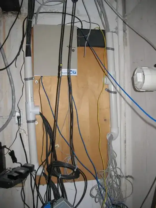

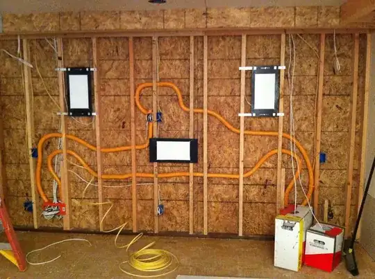

If you are at construction level I would most certainly advise you use PVC conduit to run multimedia cables. In Europe I have noticed that nobody bothers too much about that in home construction because it is an extra cost. In Africa we used them everywhere because they are a time saver! Why do I suggest using them?
  • If you clip these cables using the clips you mentioned, cable tie them or bind them somehow then they are there to stay and trying to repair / remove or add them later means ripping the drywall off.
  • Houses are built to last 100+ years. People are going to want to add new technology that will require new wires. Fibre optic? People are not going to rip drywall off so they will have to run it on top somewhere, drill new holes and that is iffy.
  • Maintenance. Many times someone moves into a new house only to discover that the wiring has issues. Maybe someone forgot to connect one junction, or the incorrect gauge was used. It's also not that uncommon for multimedia cables to have a fault in the middle of the CAT5e--with PVC tubes just run a new section and viola, sorted.
There are many types of PVC conduit. The hard plastic is typically used for high voltage cables but you can use the bendy type for multimedia cables. Be advised not to run multimedia with high voltage as this will cause interference.
Hard PVC conduit
Flexible Conduit
How it should be used
How it should NOT be used
People will have various needs and you cannot predict all of them. At least you can provide an easy clean way to allow maintenance. I wish my house had this done. Instead, I have to pull a floor board, drill through beams, and install ugly surface conduit--just so I can have HD TV downstairs from my Multimedia Centre which is upstairs only 2.8 meters away.

  • This is an old post, but just to pile on: the "how it should be used" post shows a lot of bending in the orange tubing (Non-Metallic Tubing, NMT). There is a rule that states you should **never** have more than 360° of bends in a single tube, between "pull points". If possible, limiting your runs to 180°, maximum, of bending, will really help in pulling more cable. And don't forget the "vacuum cleaner pulling a plastic bag tied to a pull-string" method of starting the cable run. – whiskeychief Oct 27 '19 at 18:00
