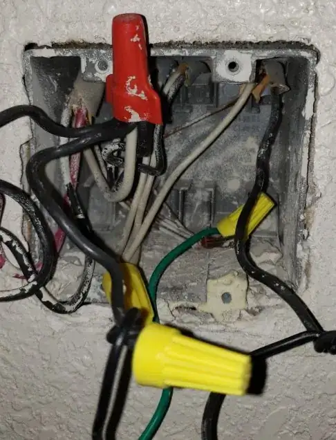

I am putting in some wemo dimmers to replace my existing dimmers in a three gang box, and came across this wiring:
I marked areas of concern with red circles.
  • It seems that the two dimmers are grounded to each other (the boxes in the middle and right). The ground wires are just tied together, nothing else.
  • The cables to the lights are also grounded together (but I can't see grounding from anywhere else).
  • Also, it seems that the neutral wires are tied to a ground wire that is from a 3 way switch. This is the other end of the three way switch:
The light gray wire (as opposed to the dark grey) I'm assuming is a white wire used as part of a traveler.
Here are pictures of the actual boxes:
My #1 concern is this: is it ok for those neutrals to be tied to a ground wire? Should those dimmers be grounded to eachother?
Thank you so much for your time and consideration!
Brian

    Briefly, neutrals shouldn't be tied to ground, and the switches grounded to each other is pointless. Maybe they tried to tie the grounds to the other ones in the box and it slipped off? The rest of this will take more time to decipher. – JPhi1618 Mar 21 '19 at 15:07
    I took the liberty of amending your drawings to label wires, cables and switches. Sorry for the ugly, I am stuck on Adobe Ideas. I chose colors found in the $4 5-packs of colored electrical tape, in case you want to make reality match drawing. Marking both travelers yellow is a 'harper'ism, but in your case that will be changing quite soon. – Harper - Reinstate Monica Mar 21 '19 at 17:06
The nut of the problem is the ground wire joining the neutrals in drawing 1. This is a bootlegged attempt to fix a fundamental problem of bringing 5 wires: 2 travelers, always-hot, neutral and ground in a /3+ground cable.
Everything in drawing 1 is bootlegging neutral from ground. This is bad and needs to be fixed Right Now. Not least, nothing in that box is actually grounded.

  • remove the 3-way from the 2-gang box. There, see the clump of blacks in the 2-gang box, which include a white from the /3 cable? Remove the white and replace it with the /3 cable's black (remove yellow tape). Now you have a 5-wire bundle of eevery black in the box (not blueblack) and a pigtail to each switch. These are always-hot.
  • Notice the bundle of neutrals here. Add the /3 white wire to it, and also add a white pigtail that will go to the future 3-way smart switch. Now you have a 6-wire bundle (you will need a red or tan wire nut for that) with all white wires and a pigtail to each switch. These are all real neutral.
  • Remove the 3-way from the 3-gang box. There, see the /3 white going to a clump of black pigtails going on to switches? Remove the white and replace it with the /3 cable's black (remove yellow tape). Also add a black pigtail that will go to the future 3-way smart switch. Now you have all 4 uncolored blacks in a bundle (supply and 3 pigtails). These are always-hot.
  • Notice the bundle of neutrals here. Remove the /3‘s green wire and replace it with the /3’s white wire and add 1 white pigtail for the smart switches. Now you have 5 white wires (one from every cable plus the pigtail) so you'll need a red nut for this. This bundle is full; you'll add the smart switch pigtails to the other end of that white pigtail. All these white wires are neutral.
  • Now you have a loose ground wire. Joint it with every other ground in the box.
  • The red wire is now the only comms wire.
Whew!!! We have corrected the bootleg wiring, and have honest always-hot, neutral and safety ground in both boxes. The 3-way circuit is wrecked: cap off its wires until you procure a correct smart switch.
  • The 3-way smart switch "master" must go in the 3-gang box. It connects to line/always-hot (black), neutral (white), load/switched-hot (blue), and if needed, comms/traveler (yellow-red).
  • The 2-gang gets the 3-way smart "remote". It takes line/always-hot (black), neutral (white) and if needed comms/traveler (yellow-red).
  • The other smart switches install according to their instructions. The load/switched-hot wires all have colored tape on black.
