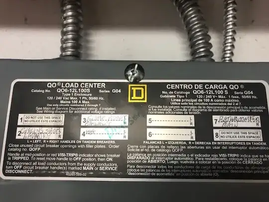

UPDATED IMAGES INSIDE THE PANEL enter image description here
Just so people understand the context this is a new house I moved into. I didn’t ignore rules, I’m just trying to fix an issue that was there before, and do it safely. Your input is very helpful.
The top left of the panel is input to the sub-panel. The panel came with the two breakers on the left, and the breaker all the way on the right. Coming into the box were essentially three sets of wires through one metal conduit, with each set having a piece of electrical tape around them. There’s a black, red, and white bundled together, and another black red and white bundled together (14g). The two black wires go to one breaker, with the white neutral above it, and the two red wires go to the next breaker, one neutral above it. The 3rd set is a pair of black and white 12g wires that go to the 20A rightmost circuit. Then there are two circuits in the middle that have the visible square D symbol that I added. The first one on the left is the GFCI 15A circuit, not hooked up to anything but the neutral and turned off, the failed addition, and a 20A circuit hooked up to a 12g pair of black/white wires that goes out to topmost right position in the sub panel to an outdoor GFCI outlet I added (the only things I added to this panel).
Curious to know if this changes anything. Thanks for your thorough thoughts!

  • Can you post a photo that shows the breakers? – ThreePhaseEel Mar 28 '19 at 01:18

  • I think that the MWBC hots are actually on two poles in this case, just in an unusual configuration. Notice that the bottom tandem breaker has two black wires connected, and the tandem above has two red wires -- assuming conventional NM/3 color codes, these are probably two MWBCs with one hot on each of the two poles. The breakers for each half of the MWBC are not next to each other, and so cannot be handle tied, but the neutral probably isn't actually overloaded as currently installed. – Nate S. Mar 28 '19 at 16:24
  • @Nate Ah, OP posted some pix. **This is in conduit** which means **colors don't mean anything**. However an effort was made to mark the grouping of the wires, so if that is reliable, then yes - they are on opposite poles and thus *less unsafe*. Proper installation requires handle-ties, so the neat and simple answer here is a quadplex breaker (if QO makes those). If not, 2-pole breakers are needed. – Harper - Reinstate Monica Mar 28 '19 at 16:47
  • True, with conduit we can't know for sure, but I think it's pretty likely. Agreed handle ties are needed -- I'm guessing that originally the bottom breaker was that old offset tandem type as well, and was handle tied to the one above, which would have been a code-compliant installation. When the bottom breaker was replaced with the new style, the handle ties didn't fit so were discarded. – Nate S. Mar 28 '19 at 16:59
  • @NateStrickland yup, we're thinking the same thing. I just said pretty much that in an edit. – Harper - Reinstate Monica Mar 28 '19 at 17:14

Amazingly enough, the existing wiring is almost right -- the two blacks are on one leg, and the two reds are on the other leg, as they should be, so you actually don't have to worry about burning your house down with this!
However, there is still a problem here, and that is that there's no common maintenance shutoff for either multi-wire branch circuit originating in this panel. Code requires this so that somebody doesn't shut one half of the circuit off, then get bit by the neutral because the other half is still allowing the neutral to be "live".
At this point, we then run into trouble. Normally, I'd say "go slap a quadruplex breaker in there and call it a day", but the closest thing to a quadruplex QO is a pair of QO tandems with their inner poles handle tied using a QOTHT. However, that only provides common maintenance shutoff for the inner pair of poles, so its not an option.
Instead, what I would do, since you can pull the single pole GFCI from the failed addition out and have a space spare atop that, is get two QO215GFI breakers and install them in place of the failed addition and the two tandem breakers, thus displacing the 20A breaker up a space. Each black/red/white bundle lands on the load lugs of its corresponding circuit breaker (black/red to the hots, white to the load neutral), and the line neutral pigtails go into holes on the panel neutral bar. You'll have to remove the remaining twistout from the panel deadfront before you put it back on, as well. This also takes care of all your GFCI needs for those circuits as well, of course.

  • Technically if OP could find another of those weird old QO tandems with the handles offset instead of next to each other, both sets of those could be handle tied, and the circuits would be up to code. I'm guessing that's how it was installed originally, and then the bottom breaker got replaced with the new style, and the handle ties no longer fit so they were removed. – Nate S. Mar 28 '19 at 16:45
  • Can't you just stack *three* QO tandems with two QOTHTs between them? – Harper - Reinstate Monica Mar 28 '19 at 17:27
  • @Harper -- you could, but since the GFI breaker he added but can't use can just be pulled back out again, we don't need to do that sort of stunt :) – ThreePhaseEel Mar 28 '19 at 22:37

  • Now that I can see the photo, I count 6 poles of circuit breakers and 6 separate neutral wires (plus the curly for that AFCI/GFCI breaker). So I think I was right, you described it as a "shared neutral" but that's not what you have there. Not sure what you meant by that but this is just standard stuff. So my suggestion of just swapping breakers would be the way to do this. – JRaef Mar 28 '19 at 19:13
