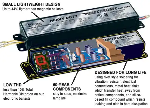

I would suggest removing the old light fitting and buying a new one and INSIST on an electronic ballast. The electronic ballast does not need any starter plugs and handles the initial output voltage much better. It does not cause flickering (but if there is a problem it just does not turn on). These ballasts MUST match the wattage of the tubes. Higher or lower wattage will result in shortened life of the tube or not turn on at all.
The electronic ballast will not be influenced by humidity or temperature that much. It just runs.
The differences...
