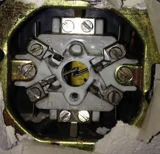

Some kind of socket
I found it in my apartment's wall.

Yes, indeed it is a Belgian phone socket.
http://www.levoyageur.net/phone-country-Belgium.html
The four pins match the four holes in your socket. The fifth pin is there to make sure you don't put it in upside down. There's a hole for it too.

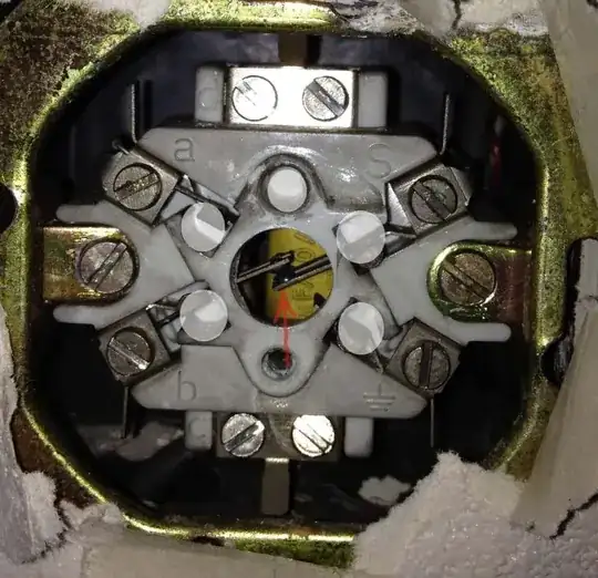

Below I mark the five pins and the switch at the center. The switch is opened by the b and S pins indicating that the socket is used. This is common for phone sockets.
Picture showing the socket with markers

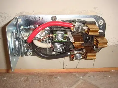

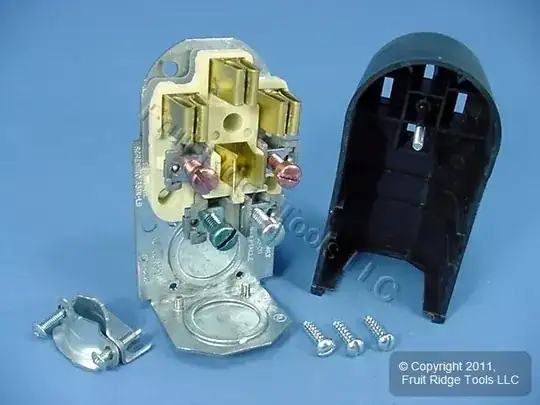

I’m not familiar with outlets in Belgium, but assuming they are typical European outlets, then it looks to be a high-voltage stove/oven or dryer electrical outlet (why it would be in the living room though is beyond me).
The labels for the four connectors (a, b, S, ground) are curious, but presumably they are hot (a), hot (b), neutral (S), and ground:
There are also two other connectors (c, d here) which are specifically part of a stove/oven outlet as opposed to a dryer outlet:

  • Any chance of it being a phone socket? – StackedCrooked Aug 05 '12 at 18:16
  • @StackedCrooked, [it’s possible](http://0.tqn.com/d/electrical/1/0/K/4/-/-/wire-phone-jack-400.jpg), but in the photo it looks too big. How big is it? Also, are there any like it in other rooms? – Synetech Aug 05 '12 at 18:18
  • It's rather small. [Here's another pic.](http://i.imgur.com/viEIS.jpg) I haven't seen any other ones like this. – StackedCrooked Aug 05 '12 at 18:24
  • Ah, then yes, it is a [phone outlet](http://www.adslcn.com/UploadFiles/FCK/image/Products/ZKX-BG13.jpg). – Synetech Aug 05 '12 at 18:26
  • @Synetech, I don’t know why one person down-voted. The answer was perfectly good based on the close-up. The other person simply un—up-voted to remove it. :roll: – Synetech Aug 05 '12 at 20:11
  • It’s not a typical European outlet (neither the one in OP’s picture nor the one you’ve shown). – Konrad Rudolph Aug 05 '12 at 20:31
  • @KonradRudolph, I never said it was a normal outlet, I said it was a stove/dryer outlet which even in Europe is special and large (like it looks in the original photo). – Synetech Aug 05 '12 at 21:24
