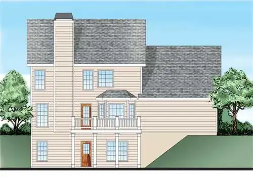

I would like to plan for an intrusion detection system in a home that is currently under construction. The home has a walkout basement that is sloping, shown in the rear elevation picture shown below.

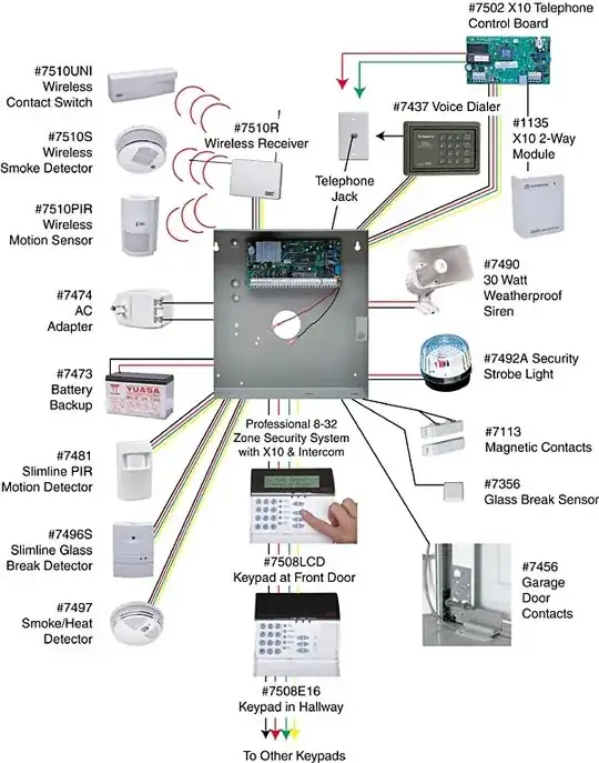

I've included an image outlining the major alarm system components to provide a clear reference when referring to different components.
I was planning on installing magnetic contacts (#7113) at each window on the basement, and first floor level. I was planning on installing a garage door contact (#7456) on each garage door. Also, recessed magnetic door contacts (not in component diagram) at each of the 3 first floor entry ways.

  • Is it recommended to install window sensors on windows that are not accessible except by a ladder (2nd floor, and some windows on 1st floor)?

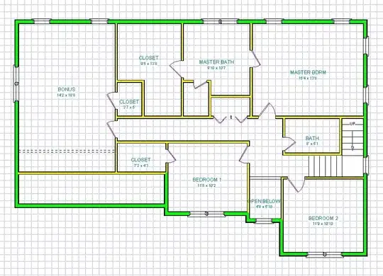

Note, that the elevation diagram is from the stock plan purchased from an architect, and the other floor plans are something I put together to show some modifications made to the stock plan/window placements.

You'll want a keypad anywhere you normally enter/exit the house, such as by the garage door or back door. As @bib points out, you may also want one in the master bedroom to be able to use panic, or see status of the system.

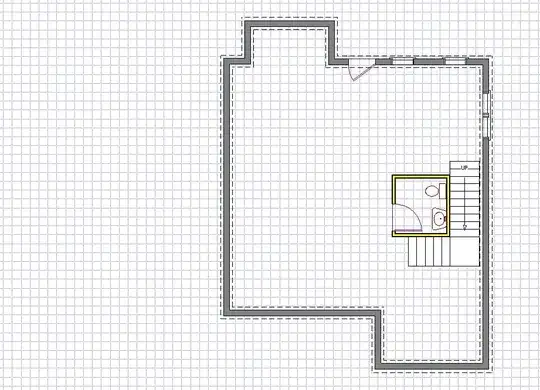

I would probably put motion sensors in:
  • top-right corner of family room - covers windows at the back
  • somewhere in entry way (a 360-degree ceiling-mounted would work well) - covers anyone moving through the main area of the house and using the basement stairs
  • top-right corner of basement - covers the basement windows
Of course you can put more if you want, but you need to think of what you're trying to protect from. If someone breaks in through, eg, the dining room, they are probably going to walk around and set off a motion somewhere. If you do have enough valuables in a room that someone may break in, steal everything from that room and leave, then you may want to put motion or some other sensor in there.

  2. The thief that comes in a gutter repair truck probably has ladders. My general rule is all windows get sensors unless they are visible from road and require more that a 15' ladder, or hidden and need a 25' ladder. It's OK to daisy chain a few windows together if they are likely to be open at once to reduce the number of runs, just make sure the wiring is good and accessible from the sensor hole with slack.

  5. Motion sensors are the best. Garage, two on main floor (maybe mounted on walls of central closet pointing out. cover the entire floor), and one 2nd floor hall.
