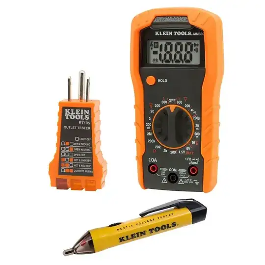

I also highly recommend getting a digital multimeter. They don't cost much and are incredibly useful. Even better is to get a Electrical Test Kit like this: enter image description here which gives you a basic multimeter, a non-contact tester and a receptacle tester (or magic 8-ball as Harper refers to them), which together can help troubleshoot a lot of issues much easier than with a multimeter (especially an old analog one) alone.
