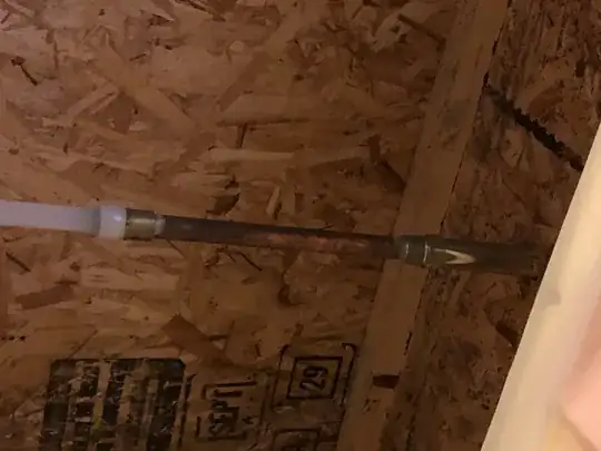

Currently we have Romex wire running straight into the ground. (This is how it was when we moved into the house. I have attached a picture below.) This feeds basic outlets and the garage door. We would like to run either straight to a circuit, or a small sub-panel to provide for the 110v (outlets and garage door, and 240v - EV)

When laying conduit, keep your bends to an absolute minimum between access points; use conduit bodies at corners to give easy access. You see a conduit body in your picture, but you can't use that one because service wires are in it.

The weird cable with male ends on both ends is probably a "suicide cord" for running a generator. Or should I say a "murder cord" because his plan was to plug one end into a generator and the other end into the garage feed, to backfeed the garage then backfeed the house. And maybe he turns off his main breaker first and doesn't kill a lineman. (Because when a 120V generator backfeeds a 120/240-9600V poletop transformer, the voltage on the backside of the transformer is, guess what! 9600 volts. That's how transformers work.)
Even worse, it sounds like rather than running a 120/240V /3 cable, he was using two separate cables to backfeed each leg separately. What a hokey-dokey rig. This is what fools like that do. Just remove the plug ends at one end so nobody can plug it in.
On the remaining buried cables, you might dig 'em up for a closer look. If they are NM, tear 'em out - they are ruined. NM is not wet-rated. If they are UF, see how deep they're buried. If it's <24" it's too shallow, tear it out. Otherwise you can disconnect it, pull it through the building, slip a Sched. 80 PVC conduit over it and rebury it (at the bottom, an elbow of course), and then provide physical protection up to a proper Code building entrance. And then put them back in service. Free wire :)
