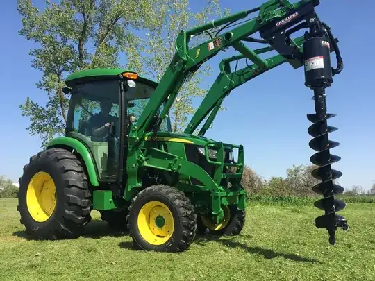

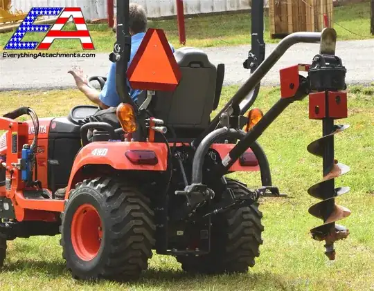

2) Tractor Mounted Auger / Post Hole Digger
This one is front-mounted
These are also found mounted on the rear PTO
For deeper holes, you use a longer auger
Naturally you would hire this tool rather than buy it. If you have no tractor then its better to just get a contractor to do it - probably drill all your holes in a morning session if you pre-clear access and clearly mark the locations before-hand.
