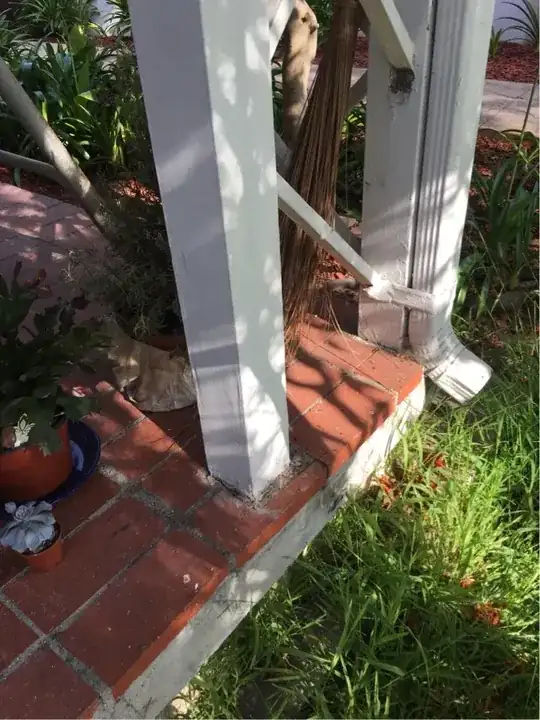

We’re getting ready to paint and I was checking around my porch. There are three columns that support the roof over my porch. One of them had a decorative cross member that was dislodged because of dry rot at the location where the cross member was nailed to the column. I saw some dry rot there and started to excavate the rot. rot dim 1 rot dim 2 rot dim 3 can see concrete columns base
Here are some pictures of the bottom of the post. It has a small amount of concrete around the posts. The post goes into the concrete an inch or two deep.
What should I do about this. I think that since there are two others columns supporting the porch roof this one with the rotted base didn’t really affect the general load bearing aspect.
How should I fix this? Just add a lot of bondo, or wood filler, et.
Take the post out and put in a new one? (I don’t want to do this bc I would need to take out all he decorative cross beams.
Cut out the old wood base and graft on a nicer/new to replace the big sections that we cut out?

  • I just posted a new picture showing how the posts are attached to the porch. There are brick pavers (about 1.5" thick) on top of cement. The post are set in the cement. When I was digging out the dry rot, I didn't encounter any rebar. I might consider replacing the whole post. Should I take out some pieces of pavers just so it is easier to work with? – milesmeow Apr 16 '19 at 04:07
  • Depending on what the post is carrying, you wil need to get the weight off the post anyway. If it is only a roof and no living space overhead, it will be a simple lift. I would not remove any pavers, it will not repair invisibly, the brick ll most likely break upon removal and it looks like an oversize brick, and to find the same color will be difficult, not to mention the mortar in the joints. When the load is removed you will be able to lay it out from the top, and install the new one the same way, after hopefully you fill the cavity and set a pin, not in that order. – Jack Apr 16 '19 at 04:22
