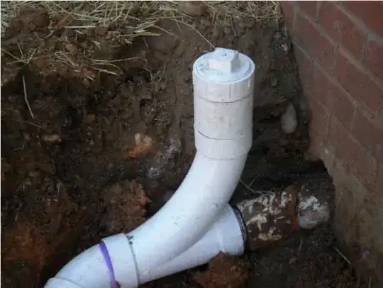

That's likely a cleanout for your sewer line. When opened, you can run an snake down the line to remove any blockage without ripping out your entire foundation. Here's what it would look like from the side:
outdoor side view
